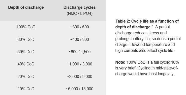

But to another point I don't get, the number of full cycles would occur faster if I were to charge it every 10%... and reach the maximum charge cycle threshold faster than If I charged it more conservatively
That's not a full cycle.
I would reach full cycles (100% charging) faster If I charge it every 10% drop with 10% (from 65 to 75%). There's an 80% drop in performance once a certain number of full cycles have been reached.
A 10% charge is not a full cycle, no matter how many times you do it. I honestly can't tell you how the battery would behave.
I don't get it. If that's the case, there would be no way of achieving a full cycle without a full discharge and then recharge to 100.
What don't you get?
Drakkith said:
What don't you get?
If I can't get a full cycle out of constant 10% charge and discharge , and lion batteries functionality is defined by a certain number of full cycles (they deteriorate 80% after a certain number of full cyles), then a Lion battery couldn't possibly deteriorate, ever, in the event of me by me doing 10% charge and discharges ad infinitum?
Pleonasm said:
I I can't get a full cycle out of constant 10% charge and discharge , and lion batteries functionality is defined by a certain number of full cycles (they deteriorate 80% after a certain number of full cyles), then a Lion battery couldn't possibly deteriorate, ever, in the event of me by me doing 10% charge and discharges ad infinitum?
...do you really believe that?
What other conclusion can I draw from your statement if Lion batteries functionalites are defined by their number of full cycles (assuming proper storage).
What you should take from my statement is that a 10% charge is not a full charge and that I don't exactly how the battery will behave. I don't know how you got the idea that only a full charge results in degradation. If that were the case, wouldn't the standard procedure be to just charge your battery to 90% or so instead of a full charge?
