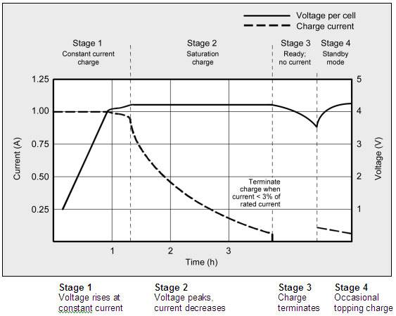

  • #70
" Choosing a lower voltage threshold or eliminating the saturation charge altogether, prolongs battery life but this reduces the runtime"
What does elminating saturation charge mean? Is it the same as avoiding large difference between various levels of charge?
  • #71
Saturation charge is the part of the charge cycle that charges the battery the last 30 percent or so. While charging, the charge current is flat for roughly the first 70% of the charge cycle while voltage across the cells increases. Around 70% charge the voltage flattens out and the current begins to drop. It's stage 2 in the graph below.
Eliminating the saturation charge prolongs the battery life, but reduces battery capacity by about 30-40%.
