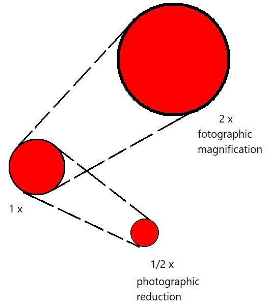

PHOTOGRAPHIC REDUCTION OR ENLARGEMENT
The proportions of a circle never change. But...
Question:
If a circle is always a circle, then how is it possible that the S/L and {[S/L]/R} ratios of a circle can vary as a function of the radius size?

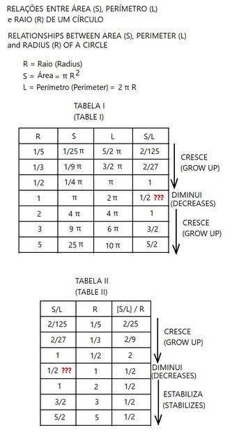

There are errors in your table for the perimeter. It should read 2/5π and 3/5π 2/3π for the first two. And S/L for R=1/2 is 1/4, not 1.
jack action said:
There are errors in your table for the perimeter. It should read 2/5π and 3/5π for the first two. And S/L for R=1/2 is 1/4, not 1.
##\frac 2 3 \pi## ?

There are many basic arithmetic errors in your charts. The [S/L]/R column should always be 1/2, for instance.

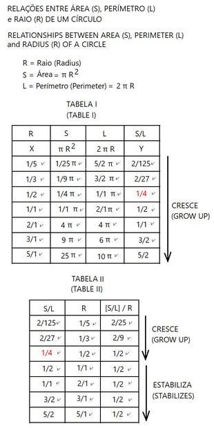

In fact, I made a mistake :sorry:.
The corrected table is below:
Note in the TABLE I a singularity, when R=2/1:
S = L ?
Certainly not!
S expresses area;
L expresses length.
P.S.:
If there is another error in the table, I apologize for my numerical dyslexia :wink:!

How about applying some simple algebra before you make the tables?
Since ##S=\pi R^2## and ##L=2 \pi R## then ##\frac{S}{L} = \frac{\pi R^2}{2 \pi R} = \frac{R}{2}## and ##\frac{(\frac{S}{L})}{R} = \frac{1}{2}##.
That is all there is to this, now you can correct your tables.

dom_quixote said:
S = L ?
Certainly not!
S expresses area;
L expresses length.
They can have have the same numerical value (which is what your table shows), but different units (which your table doesn't show).

Why don't you use letters that more closely align with what they represent?
R is fine for radius, but why are you using S for area and L for length? Better would be A for area and P or C for either perimeter or circumference.

You have errors in the first two rows of table 1.
##2\pi \frac 1 5 \ne \frac{5\pi} 2##
##2\pi \frac 1 3 \ne \frac{3\pi} 2##
