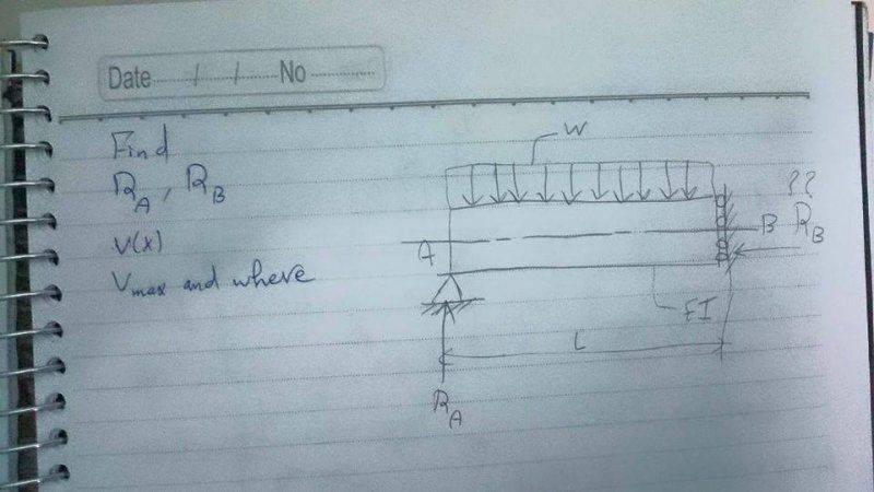

1. The problem statement, all variables and given/kno
wn data

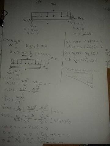

Better check that right support again. As drawn, that beam isn't going to hold up anything.
