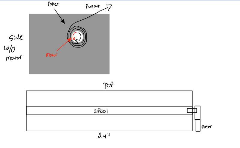

Working on designing a roller which contains a spool of material which can be pulled out by hand (Freespin) and then retracted back in by a motor.
I am working on designing a roller which contains a spool of material which can be pulled out by hand (Freespin) and then retracted back in by a motor. The first thought was to use a one way (Sprag) bearing but this will not work as the free spool direction is the same as the driven thus only achieving one or the other. It would be preferable to not use a clutch system but that is where my head is going next. Would love to hear any and all thoughts or ideas around this system. Thanks!

I think we need a diagram that shows the arrangement of the cylinder, the spool and the motor. Relative size will be important.
What force is needed to pull the material out by hand ?
What force will the motor provide to retract the material ?
What decides when the retraction motor operates ?

Here is a quick mock up to hopefully get a better understanding, I can provide a more detailed image in CAD at a later point if needed. Here the motor is depicted as direct drive, note this does not need to be the case. The retractive force for the motor is around 5 ftlb. Minimal force to pull out is desired.
Thank you again for the reply and let me know what else I can provide to gain a better understanding.
That seems to be arranged like a roller blind, which has a spring to retract it.
Is the material fixed in length on the roller, or is it consumed externally ?
You show the material being pulled upwards, against gravity ?
What supports the material while it is being retracted ?
What decides when the retraction motor will begin to operate ?
When does the motor stop retracting the material ?

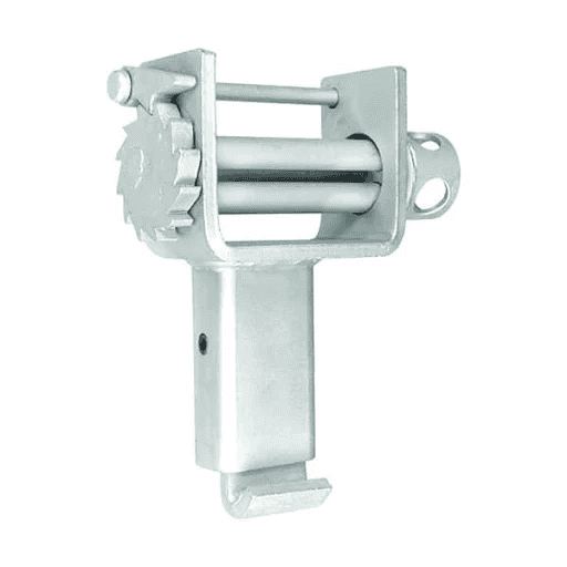

Trailer winches have a manual extension and geared retraction. A ratchet is used to switch between them.
I guess this is the clutch system you mentioned.

Similar yes, keeping the pull out force minimal is why a rotator spring was not pursued. As well as this spool needing to roll out about 7’ of material. So yes, the material is a fixed length and not consumed.
The material is pulled up, and in reference to the image, to the right, so both vertical and horizontal components of force.
The material is supported by a structure which is is covering. Think of this device like a tarp covering a semi grain trailer, although those would lack the manual pull out operation as it is powered in both directions.
A person will be in control of pressing a switch to power the retract operation (minimal complexity here for now, opportunity for automation here later, but out of scope for now.)

Yes. The ratchet winch I referenced in post 5 has no friction from the ratchet itself, which is toggled out of the way when in extension mode.
