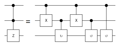

I have a concrete follow-up question, based on a misunderstanding.
A controlled-Z operation on ##n## qubits is represented by the matrix ##I - 2 \left| T \right\rangle\left\langle T \right|## where ##T## is the all-qubits-on state. ##T## comes last in the state vector, so the ##n## bit operation's matrix is a ##2^n##-by-##2^n## matrix with 1s along the diagonal, except the bottom-right value is -1. For example, the 3-bit operation has a matrix like this:
##\begin{bmatrix}
1 & 0 & 0 & 0 & 0 & 0 & 0 & 0 \\
0 & 1 & 0 & 0 & 0 & 0 & 0 & 0 \\
0 & 0 & 1 & 0 & 0 & 0 & 0 & 0 \\
0 & 0 & 0 & 1 & 0 & 0 & 0 & 0 \\
0 & 0 & 0 & 0 & 1 & 0 & 0 & 0 \\
0 & 0 & 0 & 0 & 0 & 1 & 0 & 0 \\
0 & 0 & 0 & 0 & 0 & 0 & 1 & 0 \\
0 & 0 & 0 & 0 & 0 & 0 & 0 & -1
\end{bmatrix}##
The above matrix is an example of the matrices under question. Anyways, I was under the impression that breaking this operation into smaller operations required some of the operations to overlap. For example, you can break it into several singly-controlled nots and quarter-turn phase gates:
But it shouldn't be possible to split the operation into non-overlapping pieces because that would allow communication across wires without any interaction.
Given that the controlled-Z is an example of the matrices being talked about, and apparently we can factor those matrices into ##SU(2) \otimes SU(1) \otimes U(1)## parts, why doesn't that allow us to factor the circuit operations into operation-affecting-first-2-wires, operation-affecting-last-wire, and ignored-global-phase-factor?
Argh, I figured it out immediately after posting. It doesn't factor into ##SU(2) \otimes SU(1) \otimes U(1)##, it factors into ##SU(7) \otimes SU(1) \otimes U(1)##. I mixed up the number of wires being operated on with the number of +1s and -1s appearing on the diagonal and created some nonsense.
