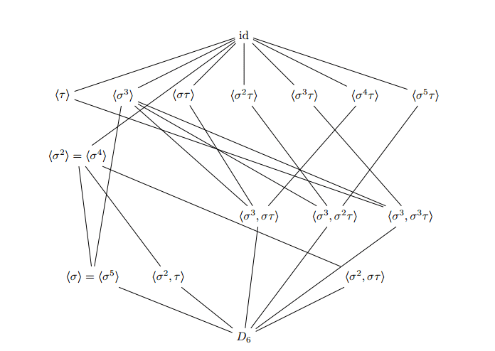

I want to make the diagram for the dihedral group $D_6$:
Subroups of order $2$ : $\langle \tau \rangle$, $\langle \sigma\tau\rangle$, $\langle\sigma^2\tau\rangle$, $\langle\sigma^3\tau\rangle$, $\langle\sigma^4\tau\rangle$, $\langle\sigma^5\tau\rangle$, $\langle\sigma^3\rangle$
Subgroups of order $3$ : $\langle\sigma^2\rangle$, $\langle\sigma^4\rangle$
Subgroups of order $6$ : $\langle \sigma \rangle$, $\langle \sigma^5\rangle$, $\langle\sigma^2, \tau\rangle$, $\langle\sigma^2, \sigma\tau\rangle$
Are there more for each order? (Wondering)
The subgroups of order $4$ are those that are isomorphic to $\mathbb{Z}_4$ or to $\mathbb{Z}_2\times\mathbb{Z}_2$, right? (Wondering)
There are no elements of order $4$, so there are no subgroups of order $\mathbb{Z}_4$, right? (Wondering)
Are the subgroups that are isomorphic to $\mathbb{Z}_2\times\mathbb{Z}_2$ the $\langle a,b\rangle$, for all $a, b$ the elemennt of order $2$
($a,b \in \{\tau, \sigma\tau, \sigma^2\tau , \sigma^3\tau , \sigma^4\tau, \sigma^5\tau , \sigma^3\}$ ) ? (Wondering)

Hey mathmari! (Smile)
I don't think there are more of order 2, 3, and 6.
Oh, and aren't $\langle\sigma^2\rangle$ and $\langle\sigma^4\rangle$ the same sub group?
And $\langle \sigma \rangle$ and $\langle \sigma^5\rangle$ as well? (Wondering)
Yes and yes.
But suppose we pick $a= \tau, b=\sigma\tau$.
Doesn't that mean that $\sigma\tau\cdot \tau = \sigma$ is in the sub group as well?
But then, the whole group is generated! :eek:

Are the subgroups of order $4$ the following?
$\langle \sigma^3, \sigma\tau\rangle, \langle \sigma^3, \sigma^2\tau\rangle, \langle \sigma^3, \sigma^3\tau\rangle$

Using the following part:
Code:
  \node (one) at (0,2) {$\text{\foreignlanguage{english}{id}}$};
  \node (2a) at (-6,0) {$\langle\tau\rangle$};
  \node (2b) at (-4,0) {$\langle\sigma^3\rangle$};
  \node (2c) at (-2,0) {$\langle\sigma\tau\rangle$};
  \node (2d) at (0,0) {$\langle\sigma^2\tau\rangle$};
  \node (2e) at (2,0) {$\langle\sigma^3\tau\rangle$};
  \node (2f) at (4,0) {$\langle\sigma^4\tau\rangle$};
  \node (2g) at (6,0) {$\langle\sigma^5\tau\rangle$};
  \node (3) at (-5.5,-2) {$\langle\sigma^2\rangle=\langle\sigma^4\rangle$};
  \node (4a) at (0.5, -4) {$\langle\sigma^3,\sigma\tau\rangle$};
  \node (4b) at (3,-4) {$\langle\sigma^3,\sigma^2\tau\rangle$};
  \node (4c) at (5.5,-4) {$\langle\sigma^3,\sigma^3\tau\rangle$};
  \node (6a) at (-5, -6.5) {$\langle\sigma\rangle=\langle\sigma^5\rangle$};
  \node (6b) at (-2.5, -6.5) {$\langle\sigma^2,\tau\rangle$};
  \node (6c) at (3.5, -6.5) {$\langle \sigma^2,\sigma\tau\rangle$};
  \node (G) at (0, -8) {$D_6$};
  \draw (one) -- (2a) -- (4c) -- (G);
  \draw (one) -- (2b) -- (4a) -- (G);
  \draw (2b) -- (4b) -- (G);
  \draw (2b) -- (4c);
  \draw (one) -- (2c) -- (4a);
  \draw (one) -- (2d) -- (4b);
  \draw (one) -- (2e) -- (4c);
  \draw (one) -- (2f) -- (4a);
  \draw (one) -- (2g) -- (4b);
  \draw (one) -- (3) -- (6a) -- (G);
  \draw (2b) -- (6a);
  \draw (3) -- (6b) -- (G);
  \draw (3) -- (6c) -- (G);
I get the following result:
Is this correct? (Wondering)
Or have I forgotten an arrow? (Wondering)

Shouldn't there be a couple more arrows to the subgroups of order 6? (Wondering)​
Shouldn't there be an arrow from $\langle\tau\rangle$ to $\langle \sigma^2,\tau\rangle$? (Wondering)
