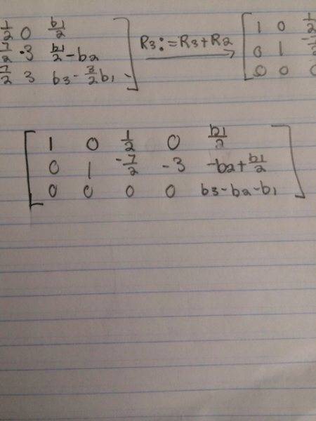

Let A be the matrix
[2 0 1 0
1 -1 4 3
3 -1 5 3]
Let b= [b1 b2 b3] transpose
What equation must be satisfied by the components of b in order to guarantee that there will exists a vector x= [x1 x2 x3 x4] transpose
satisfying the equation Ax=b. Justify your answer.
I know C(A) is the orthogonal component of the left nullspace. Also I know that the rank of the matrix of is 2 and b must belong to the column space. Where do I go from here? This is not a homework question, I am simply trying to get a better understanding of the subspaces. I am a much better learner for things with physical applications and these ideas have been far to abstract for my liking.

You're making this much more complicated than it deserves.
Set up an augmented matrix whose first four columns are the columns of A, and whose last column is your vector b.
$$\begin{bmatrix} 2 & 0 & 1 & 0 & | & b_1 \\
1 & -1 & 4 & 3 & | & b_2 \\
3 & -1 & 5 & 3 & | & b_3 \end{bmatrix} $$
Use row reduction to get the matrix on the left in reduced row-echelon form. As it turns out, one of the rows of the matrix turns into all zeroes. How does that affect the entry in the fifth column of this same row?

Handwritten row-reduced augmented matrix with rows 1 0 1/2 0 b1/2; 0 1 -7/2 -3 -b2+b1/2; 0 0 0 0 b3-b2-b1, with an earlier row operation R3 := R3 + R2 shown above.
I've reduced it to this augmented matrix. Now what?
Your work looks fine. Now, translate the augmented matrix into a system of equations. For example, the first row represents 1x1 + 0x2 + (1/2)x3 + 0x4 = b1/2.
What do the other two rows represent?
BTW, when you're working with augmented matrices, it's a good idea to draw a vertical dashed line to separate the coefficients of your matrix from the column that represents the vector b.
