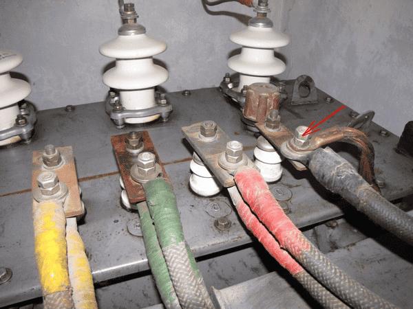

I'm modeling a substation for a game. I would like it to be generally technically correct. Currently, I'm modeling the main xformer and I noticed they have 4 terminals on the low side. I can guess these are for phases A/B/C plus a neutral. My question is where would this 4th terminal normally be connected in a substation setting?

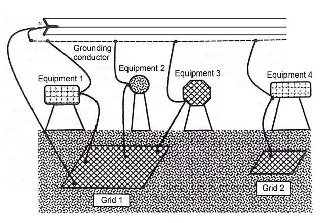

I saw those articles. But unfortunately it was more theoretical than practical. I guess what I'm asking if I walked into a substation, what would that 4th connection look like? Is it just strapped to an earthing connection in the ground or tied to the xformer case?
Hmm, is this article any better?
https://eepower.com/technical-artic...tion-grounding-parts-of-the-grounding-system/

The floor of the sub-station will have a grid of flat copper straps on the surface, earthed through deep holes in the ground. The 4th connection, as an earthed neutral, will be connected to that grid with a strap. The chassis of the transformer will be separately bonded to the earth grid.

Hello! The ground wire is shown with a red arrow. This connection must be made at the transformer terminal at the neutral connection point. The transformer housing is connected to the ground loop by a separate conductor. When designing, please specify the operating mode of the neutral conductor - TN-C or TN-S.
