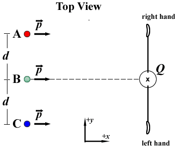

Angular momentum and torque plays the rotational role as momentum and force
Top view diagram of three balls A (red), B (green), and C (blue) each with momentum p moving right toward a vertical rod pivoted at point Q, with separation d between them and a +x, +y axis key at bottom.
https://scripts.mit.edu/~srayyan/PERwiki/images/b/b3/3BallsTurnTable.png
Now when ball A, B and C hits the apparatus, there will a force of impact from each of them on the apparatus. We can determine the way the apparatus will rotate around Q, based on the angular momentum w.r.t. Q by the particles A, B and C. We can do that by using conservation of angular momentum w.r.t Q.
