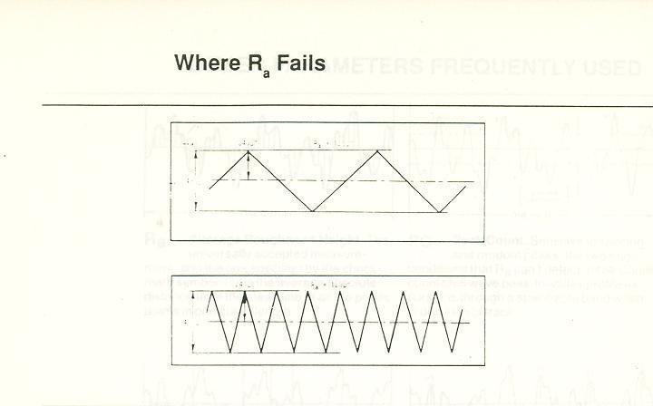

as a product manager of the company that invented the industrial method of measuring surface TEXTURE, I can tell you that Ra is a worthless parameter. It is the average of the peak to valley height of a surface profile over a sampling length..average being the key word.. it is little better than your finger nail is determining suitability of a surface. in addition the tolerancing you mentioned does nothing to restrict the manufacturer form wasting time and money over finishing the surface. there should be a minimum Ra value as well.
Finally, the value assigned is strictly arbitrary unless some function part that has lasted over time had such a surface texture Average Roughness reading.
Note attached illustration of two surfaces with the identical parameter Ra ( used to be CLa, AA, and most wrongly RMS pre 1960s), will oil adhere to these two surfaces the same? will light reflect the same/ will they perform identical functions regarding electric conductivity?
Ra is little better than your finger nail..
  • Two surface profile diagrams titled Where Ra Fails, each with a dash-dot mean line; the upper shows widely spaced triangular peaks and valleys, the lower shows many closely spaced, similar-height peaks and valleys, illustrating two profiles with the same average roughness value.

That chart simply won't exist. Materials are different in so many ways, that there really isn't such a thing as a "standard" chart of parameter vs. parameter.
Having said that, in my experience, surface finish typically had more of an effect on LCF life than HCF, IIRC.
