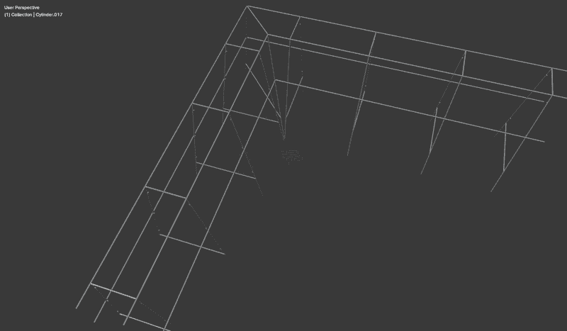

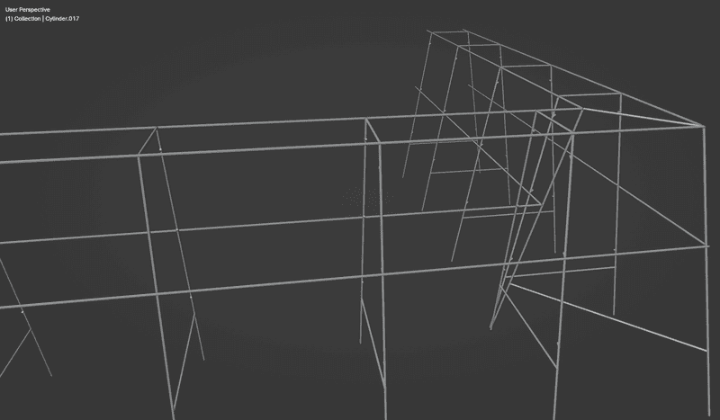

House building idea: earth filled walls made of corrugated galvanised iron and reinforcing bars

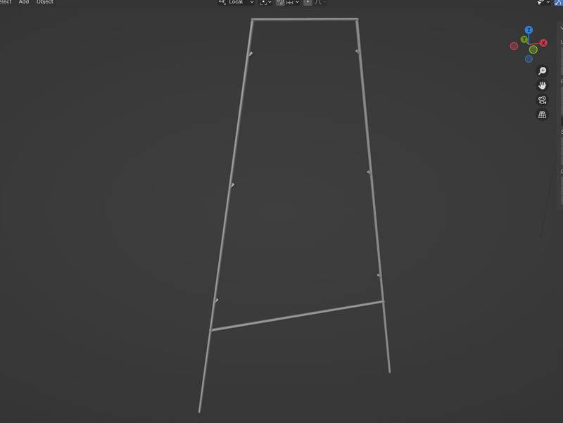

There are lot of people on the Internet trying to build a cheap and sustainable house. Inspired by them I came with the idea of building external walls of Corrugated galvanised iron (CGI) and rebars and fill them with earth / sand. The basic element of the wall structure is this rebar trapeze with hooks on the inner side:
Both its legs are placed fully into the ground up to the horizontal bottom bar (base). The above the ground height of the trapeze is 3 meter, the base - 1m and the top 0.5m Many such trapezes are placed at the perimeter of the future house and welded together into the following structure:
Next CGI sheets are perforated and hanged on both sides of the trapezes (on the inner hooks) starting from the bottom. Once they are filled with earth, next level of CGI sheets is added upon the lower level and also filled. During the filling, once the earth reaches their level - opposite hooks can be connected with metal wire to reduce chances of trapeze deformation. And so on until everything is filled up. Inner space can be divided into rooms using metal rods and drywall (gypsum panels). Ceiling and the roof will be supported by a separate metal rods structure of appropriate size. Some of those metal rods might be buried inside the earth of the walls. Now my primary questions...
1. Do you think such a construction is stable enough (on its own and in case of an earthquake)? If not, how long should the base and the top be, if the height should stay 3m?
2. What kind of rebars - radius, type, etc. should I use in such a case?
There are also some secondary questions, but they are less important...
3. Should I try to hermetically seal the holes of the CGI sheets or will the rainwater drain through the inner filling further to the ground?
4. What kind of ceiling would you recommend? The material should provide good thermal insulation (preferably also acoustic, be inflammable and not cause health problems).
5. How would you recommend to seal the connection between CGI sheets on the bottom and the ground?
6. What kind of CGI sheets would you recommend for the walls and which for the roof? (at the end the structure should be as cheap as possible, but not cheaper - safety first!)

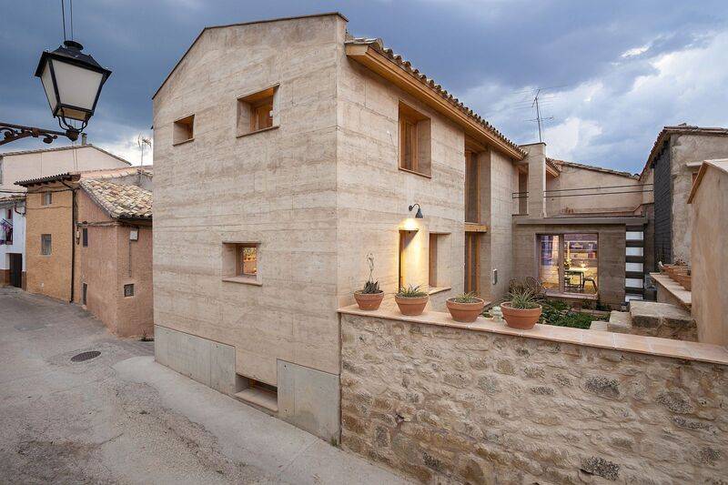

What would be the advantages compared to rammed earth houses?

Those are labor intensive and time consuming - you need to wet the soil, compact it, let it dry. And this for each several bricks. In my case you just fill the walls (maybe even with a small excavator) and that's it. You don't really need to compact it too much (or at all), since even if the soil will sink with the time 20-30 cm - it will neither be noticeable from outside nor will it have negative impact on the stability of the structure. You'll be able to add soil with the time. Another advantage - the soil is not exposed to the rain, wind, sun... Those rammed earth houses do not hold in their original shape for too long...

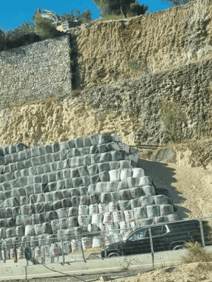

Then why not just pack some shipping containers and bury them?
Because the wall pressure rating of a shipping container, is less than the hydrostatic pressure of the soil.
Shipping containers are designed to stack and support loads vertically, not to be squeezed by wet soil. Shipping containers require a concrete retaining wall, and a water barrier.
If a container is buried, so it can be driven over by a vehicle, then it also needs a reinforced concrete or steel cover.

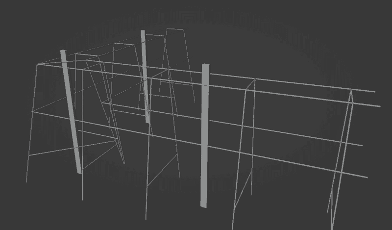

I actually wanted to use them to bear the ceiling/roof by burying them into the walls like in the picture bellow.
I've heard many interesting remarks so far, but nobody had answered my primary question - is this structure stable? Earthquake stable?...

Not as originally presented.
Shear loads must be counter-acted by diagonal bracing on the three planes (which is also easier to do with screws than welding).
Just imaging that each corner in your diagram, where two bars meet, gives those certain freedom to rotate respect to each other under wind and ground forces.

Mud walls in specific environments has such climate effect.
That is, when it is in connection with the inside, without any moisture barrier like metal sheet or such.
Even a thin layer of plastic paint might ruin the thing, since it's mostly about the control of internal moisture levels.
Given that the thermal insulation of those walls is really not something to brag about, the effect of the thermal mass alone is quite controversial.

3. surround the walls with big bags ( https://en.wikipedia.org/wiki/Flexible_intermediate_bulk_container ) filled with earth and stacked one upon another (3 layers), optionally interlocked with barbed-wire to hold all this together. On the inner side the bags will be stocked straight and touch the SIPs; on the external side they will be tilted a bit (by e.g. using bags with decreasing width on each subsequent upper layer) - like in the picture below. Plants can be planted into the bags walls.
What do you think about this idea? The bags with earth can obviously make the house bullet-proof and inflammable (more or less), but what about the internal temperature? Will the thermal mass be enough to keep the temperature within 20-26C without heating/cooling in mediterranean climate?
Any cons to this design?
