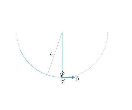

Consider the example of Tarzan swinging on a vine. Let the length be L = 10 m, and Tarzan
has a mass of M = 70 kg. The figure shows him swinging through the bottom of the arc,
where at that instant he has a speed of 13.0 m/s. What is the tension in the vine?
A. 686 N
B. 823 N
C. 1869 N
D. 1153 N
E. 1335 N
is there an easier way to solve this instead of using the angular momentum principle?? if so how??
  • Diagram of a pendulum swing: a dashed circular arc with a solid blue section at the bottom, a vertical vine from the pivot to a stick figure at the lowest point, radius labelled L, and a horizontal blue arrow labelled p showing momentum.
Draw a diagram listing all the forces.
hint there are two forces down at the bottom of the arc)
i know there is the F(tension) which points up. and the F(gravity) pointing down.
F(gravity) = -mg
but how do you know the F(tension)
never mind i got it. forgot centripetal force :)
thanks
