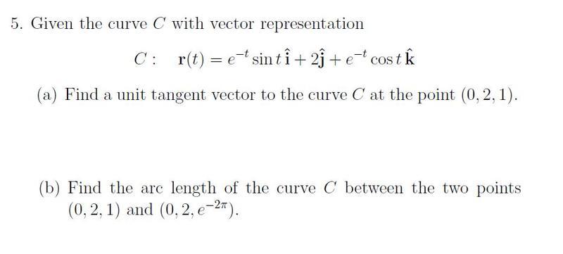

See first figure.
See second figure.

  • Typeset homework problem 5: curve C given by r(t) = e^(-t) sin t i + 2j + e^(-t) cos t k; part (a) asks for a unit tangent vector at (0, 2, 1), part (b) for arc length between (0, 2, 1) and (0, 2, e^(-2π)).

You are wrongly interchanging the curve C and the vector r(t). Whereas r(t) is a different vector for different values of t, the curve C is the set of all points mapped by r(t). We are not finding a vector tangent to r(t) but rather to the curve C! In this case, we are finding the unit tangent vector to a specific point (0, 2, 1) on C.

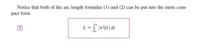

I got it from the Stewart textbook.(see figure)
The point,
[tex](0,2,1)[/tex] is when [tex]t=0[/tex]
and the point,
[tex](0,2,e^{-2\pi}[/tex] is when [tex]t=2\pi[/tex]
So they are asking me to find the length from 0 to 2pi in terms of t right?
So why doesnt,
[tex]\int^{2\pi}_{0} \vec{|r'(0)|}dt[/tex] work?

That's not what you have. There's a HUGE difference between r'(t) and r'(0) :P!
But really, before using that formula, you should know how it was derived (refer back to my (ds)^2 = (dx)^2 + (dy)^2 + (dz)^2 post). All these results aren't just magical shortcuts to finding the answer. There's an important distinction between learning and memorizing.
