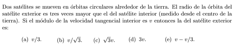

Two satellites move in circular orbits around the Earth. The radius of the orbit of the outer satellite is three times that of the inner satellite (measured from the center of the Earth). If the modulus of the inner tangential velocity is v then that of the outer satellite is:
So I guess a_1 = a_2 where
a = (v_t)^2/r
and I found that
v_2 = sqrt(3)v_1
but the correct answer is
v_2 = v_1/sqrt(3)
Could you explain me what I'm doing wrong?

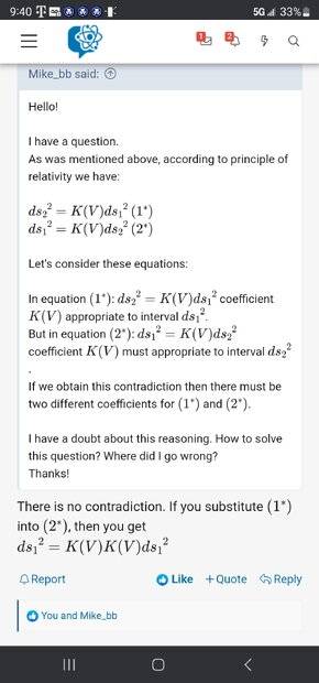

Would this not be the same?
The same as what?
