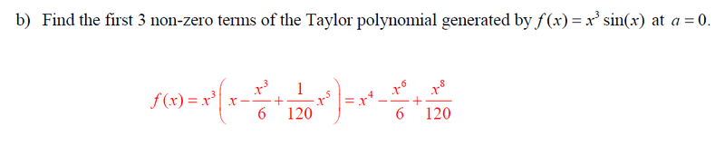

Find the first 3 non-zero terms of the Taylor polynomial generated by f (x) = [itex]x^{3}[/itex] sin(x) at a = 0.
[itex]f^{n}[/itex](x) * [itex](x-a)^{n}[/itex] / (n!)
I got the question wrong: my answer was 1/3! + 1/5! + 1/7!
Here is the answer below. I was wondering how my teacher got that answer. Do you have to do the product rule to find the derivatives?
Do you know the Taylor series for ##\sin x\ ##? He just multiplied that by ##x^3##.

The Taylor polynomial is a function of x. Your answer is really just a single number.
You wrote something in the relevant equation section. Do you know what it represents and what it's used for?
Your textbook undoubtedly has some examples that are like this problem. Have you looked at any of them?
At a=0, it means that the function f(x) is approximated near the point x=a=0. In other words, you have a Maclaurin series. Adapt and use the relevant equation from your post #1.
