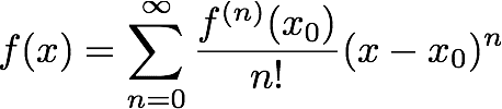

In formula 1 it says F(1) = F(0)+F'(0)+ 0.5F''(C)
Where the heck dos the C come from? I thought they were applying taylor's formula to find an approximation of F(1), around t=0. Then c=0, right? Is it because h and k are very small?
In other words, how is there room for a c, when x=1 and x0=0?
