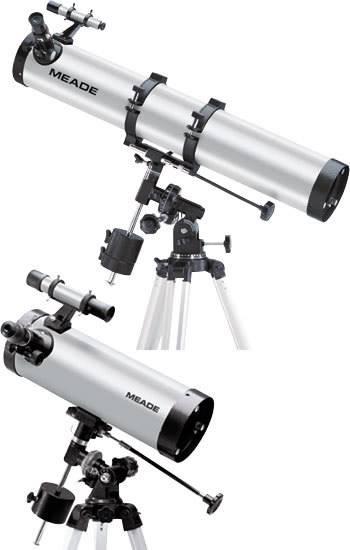

Okay, here is the rundown: I have a really inexpensive ($150) Meade reflector telescope.
Here are the specs: 114 mm primary, F=1000mm, f/8.8
I am not quite sure what the F=1000mm, f/8.8 means.
Now, the telescope is a little strange in that it has some sort of 'lens' located in the focuser tube. Yes a lens. It is midway between where the eyepiece is inserted and where the focuser tube ends in the optical tube.
It serves as some sort of relay...or a way of allowing them to make the telescope shorter and more compact. (Russ, you may recall this)
I really feel like this lens is taking away from the viewing experience. I feel it worsens the telescopes optics.
I wouldn't mind experimenting with the scope. I have an extra Crayford style focuser lying around. I was thinking of removing the old 'relay' focuser', cutting a larger hole in the optical tube, and putting in the Crayford.
I am just not sure how this will change things. I am sure there will be some math involved, but I don't mind.
Will this change the focal length? What does that mean anyway? Will I need to Adjust how high the focuser assembly is from the optical tube? (I assume I will, though I can't exactly say why!) If so, how can I figure out how high?

The f=1000mm is the focal length of the telescope, it's simply the distance from the mirror where parallel light would come to a focus.
The f8.8 is the focal ratio = focal length/aperture = 1000/146
This is a measure of the brightness of the image and the field of view,
A larger aperture collects more light and a faster (smaller f number) telescope gives a larger field of view. But a faster mirror is more steeply curved and so more difficult and expensive to figure.
I don't know this telescope but I'm guessing that if it is a short tube then the position of the focal plane 1000mm from the mirror would be too far outside the tube to mount an eyepiece and so the relay lens relocates it at a more convenient point - but possibly at the cost of some field of view.

This makes sense. The tube is short...let me see if I can find a pic. Here it is...it's the shorter one
So since F=1000mm=100cm is most likely outside of the telescope the lens must do something to correct that.
Now it seems to me that the focal length must be a function of the degree of curvature of the primary mirror. So, is there anyway to get around using the lens? Or am I better off just making a new optical tube?
I'm thinking it serves as a barlow and that if you remove it, you may just be left with a shorter focal length scope, which can still focus at a reasonable distance from the tube.
If you can remove the intermediate lens without damage, and retain the ability to re-install it, try that. Remember that the lens might not be symmetrical, so mark it so you'll know which surface of the lens goes toward the eyepiece. Another thought - that intermediate lens could serve as a field flattener instead of a barlow, so that the whole field of view comes to focus at about the same EP distance. I'm not familiar with this scope, but I'll dig around a bit.
I was thinking that - but why would you make a fast reflector and then slow it down to f8.8 ?
Wouldn't the only advantage of a slower telescope be a cheaper primary and a smaller eyepiece?
After a little research, I think Russ is right, and that intermediate lens is a Barlow. The configuration of the Meade 114EQ-ASTR is similar to that of the Orion Star-Blast 4.5" and it is marketed as a 450mm f/4. If you remove the Barlow, you will only lose magnification. The trade-off is that you will have a much larger field of view for observing extended objects like nebulae and the galaxies in our Local Group, AND everything will be brighter. At the $150 price-point any built-in Barlow is not likely to be optically great, nor is it likely to be fully coated to suppress reflection, so you may indeed improve the optical performance of the scope by removing it.
That extra optical component is called a relay lens. It significantly shortens the focal distance allowing for a shorter tube and less bulky mount.

Making your own truss tube and transferring components is a great way to learn. Remember that the 1000mm is the length of the light-cone from the primary to the focal point. Your secondary needs to be closer than 1000mm to the primary to allow for the length of the focuser - the EP needs to be 1000mm from the primary. As you build your truss-tube you may want to consider making a design in which the secondary and the focuser can be adjusted to be closer to or farther from the primary, as needed. With some EPs, accessories, cameras, etc, you may need more in-focus or back-focus ability that you originally anticipated.
so the 'eyepeice' has to be 1000mm from the primary mirror? I don't know why that confuses me.
If the EP is perpendicular to the optical tube and set back from it, how do you take that measurement. I will try to find a diagram. That would make it a lot easier!
The 1000mm is the length of the light-path, including the path from the primary to the secondary, and the path from the secondary up the focuser tube to the EP. Different EPs will come to focus at different focuser extensions, so you should expect to plan for that.
Ohhhh. I get it. 1000mm is the TOTAL length from the primary to the EP. Since it is a reflector, that length is in a sense being 'bent' around a corner since you cannot put the EP where it would block the incoming light to the primary.
It all makes sense now. Since the secondary is flat, it does the hinder the light as it comes to a focus... it only acts to redirect said light.

It would be more accurate to say that with the lens, the effective focal length is 1000mm. When you remove that lens the actual focal length (which IS a property of the curvature of the mirror) should be shorter - perhaps in the 400-500mm range. You'll have to measure that focal length and subtract the average focus tube extension to determine the how far the secondary mirror needs to be from the primary.

You may notice that the 1000mm is labeled as "effective focal length", not "focal length". Get a ruler and measure the distance from the primary to the secondary, then add roughly half the tube diameter. You'll probably get around 500 mm. The built-in Barlow increases this by about 2x, hence an "effective focal length" of 1000mm.
I think I have the same telescope as you, and I was confused as to why the focal length was 1000 mm, but the telescope was only about half this length. So I called Meade Technical support, and that's what they told me. Prior to that, I didn't even realize that there was a piece of glass in the focuser.
