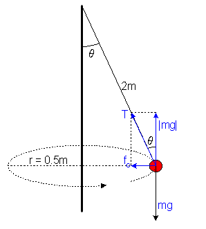

Calculate the tension in a 2m string attached to a 2kg bob that is moving in
horizontal circles of 0.5m radius.
I thought it was F=MA but the working out shows all sorts
I know the answer is 78.4N but don't know how to get there.

have you worked out this is a conical pendulum?
If your textbook has nothing anout analysing them, you could check this wikipedia address if you want to check what it means.
http://en.wikipedia.org/wiki/Conical_pendulum
the book gives:
θ = tan-1 0.5/2
= 14º
Tcosθ = mg
T = mg / cosθ
T = 2*9.80 / 0.25
T = 78.4N.
I don't know why its carrying out those particular calculations
Surely this should not be using tan-1 either since we only have the hypotenuse and opposite values.
shouldnt it be Sine?
Also just noticed that cos 14 isn't 0.25, its 0.97

I agree, the angle should be worked out with a sine function, not tan.
It would seem then that your book has some errors in the solution provided. You should be working to a diagram similar to this:

Would i be correct by saying the answer should be:
20.2N and not the one stated?
How come it changes to cosine once i have calculated the angle?The amount of errors i have found on this course is disgusting, every other page there is an error. I would never recommend anyone to ICS after what i have seen on this course.
Thanks a lot for the help so far:)
The reason it changes is because you're looking for a different side of the triangle.

Im looking for another side of the triangle, am i? i didnt think i was
Yes, because that's the only one equal to mg.
If you want to bypass the trig functions altogether you can use Pythagoras' theorem and similar triangles. Use Pythagoras to find the length of the vertical leg of the big triangle, then construct suitable ratios for the triangle sides.
So is 20.2N correct just so i know I'm doing this right?

Yes, 20.2N is good.

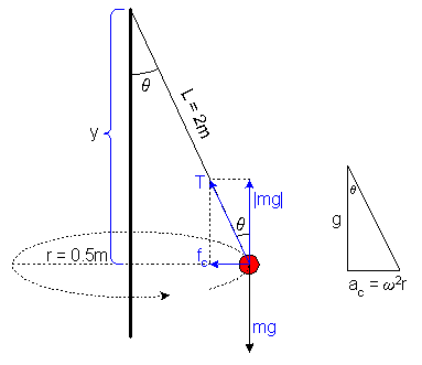

Calculate the angular speed for the bob in the previous question?
the working out gives:
cosθ = g/1w2
ω2 = g/1cosθ
ω2 = 9.8/2cos14
ω2 = 9.8/2*0.97
ω2 = 5.05
ω = 2.25 rad s-1.
Now i thought to get angular speed it is w=angular displacement/time
But this doesn't appear to be doing any of that
Thanks in advanced
They are equating the ratio of the gravitational acceleration of the mass to the centripetal acceleration due to its rotation, with the ratio of the length of the long leg of the large triangle to the radius leg:
In the diagram, [itex]y = L cos(\theta)[/itex]. The centripetal acceleration of the mass as it rotates with radius r is given by [itex]a_c = \omega^2 r[/itex].
