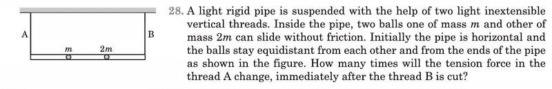

Since the pipe is light , net force and net torque acting on the pipe should be zero .
Initially , ##T_A+T_B=3mg## by balancing torques about each end of the rod , we get : $$T_A=\frac{4mg}{3}$$
Let the tension in ##A## just after cutting ##B## be : ##T_A'##
Let the normal reactions acting on the pipe due to the balls be ##N_m## and ##N_{2m}## downwards respectively:
Hence , $$T_A'=N_{m}+N_{2m}$$ (Net force on pipe is zero)
Similarly , $$N_{m}+2N_{2m}=0$$ (writing torque about A on pipe)
Let the balls have accn ##a## downwards :
$$mg-N_m=ma$$
$$2mg-N_{2m}=2ma$$
Solving these gives normal reactions ##=0## and ##a=g## which kinda makes sense for they should be in free fall .
But this would mean there is ##T_A'=0## which is the wrong answer .
I am not sure where i went wrong

If that's the case then i would have to take two accns ##a_1,a_2## for them . But i can't think of an extra equation to solve them .
Simple geometry if you assume the A end of the rod doesn’t rise.

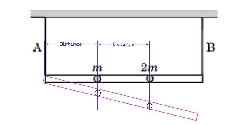

Suppose the rod’s angular acceleration about end A is ##\alpha##. Can you relate that to the balls' accelerations?

Think of strings A and B being simultaneously cut.
What would be the rate of acceleration of each ball once both are liberated from the restriction of the string tensions A and B via the hanging horizontal pipe?
That is not our case at hand, and we can see that, due to the absence of internal friction, the only function of the pipe (which is deviating from a perfect horizontal position) is to limit the free fall of one or both of the balls.
Note that both balls are now also free to slide along the axis of the pivoting pipe.
During the first instants there is no force to deviate them from a vertical trajectory, which distance from each other and from the pivot A remains the same.
Only a force can restrain one or each of the balls from falling freely.
For that force to exist in that quasi-static initial condition, it must be transferred to the ground via the string A.

I am sorry for my silly calculation. I have arrived at the right answer . ##T_A'=\frac{2mg}{9}##
But my doubt still remains . I get through intuition that there MUST be angular accn but then again i feel like we cleverly kind of cheated math ? Since , let's say the distance between each ball and end is ##x## . Then ##a_1=x\alpha , a_2=2x\alpha\implies a_2=2a_1##. But ##\alpha## itself is zero due to the net torque on a massless body is zero ?
Bling Fizikst said:
Doing that gives ##a_2=2a_1## and solving gives ##a_1=g , a_2=2g##
That’s not what I get. Please post your working.

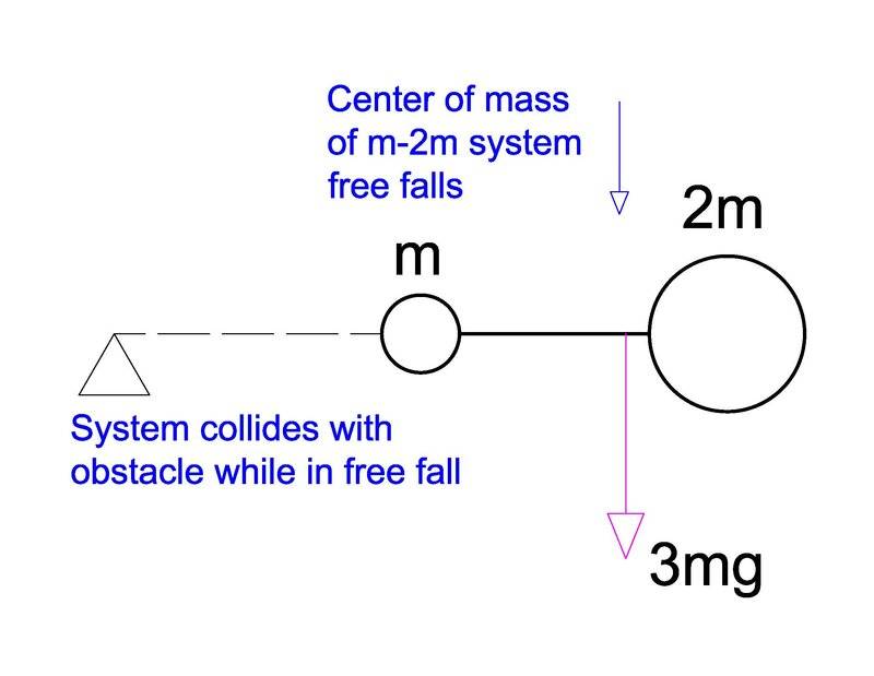

The following alternative approach, ignoring the pipe, may help you:
Consider the 3m combined center of mass in free fall.
An extension of the system (the dashed line shown in the attached diagram) collides with the obstacle A.
That collision induces a clockwise spinning of m and 2m (linked by the pipe represented by the continuous line).
Immediately after the impact, that very rotation reduces the tension in our string A down to 1/6 times the initial tension.
