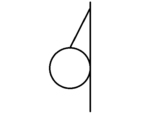

A solid uniform 45.0 kg ball of radius 0.16 m is supported against a vertical, frictionless wall using a thin 0.30 m wire of negligible mass. Find the tension in the wire.
Sinθ = opposite/hypotenuse
Cosθ = (m*g)/T or T/(m*g); I'm not sure
The angle is sin^(-1)(r/(r+0.30 m) = 19.471 degrees.
My textbook probably uses Cosθ = (m*g)/T to find the tension because that gives their answer OF 470.0 N. But, how can the force of the tension be greater than mg? I intuitively thought that maximum tension would be when θ = 0° and decrease to 0.00 N as θ goes to 90°.
This doesn't make any sense to me.
If you will draw a free-body diagram, you will see that the vertical component of the tension must be equal and opposite of the weight of the ball. The wire is acting at an angle to the vertical, so the tension in the wire must be greater than the vertical component.
If you were to support the ball from the ceiling such that the string was at right angles to the ceiling, then the tension would equal the weight of the ball exactly.

Oh yeah, thanks!
