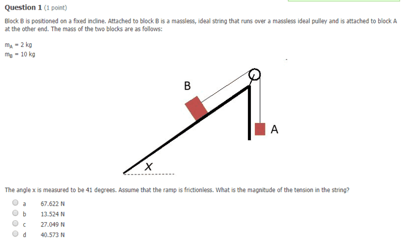

[QUOTE="gneill, post: 5935229, member: 293536"] Since the string and pulley are both massless, the string will have the same tension everywhere. Consider the Free Body Diagram of block A (you could use block B's FBD, too, but block A's is a bit simpler since the slope of the incline is not involved). You have found the acceleration of the block and there are only two forces acting, gravity and the tension. [/QUOTE]
