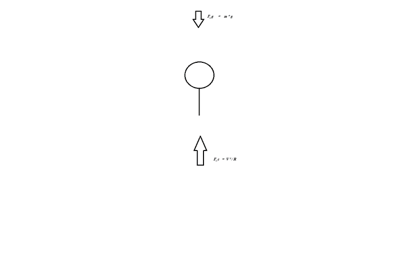

The acceleration at the top, just like elsewhere depends on the forces acting on the ball. That is why you are required to do the FBD. Do it, use the hint provided, and you will find out what the acceleration at the top is.
so there's that...I realized that since there is NO tension force acting at the top of the circle...the only forcing acting on the ball are
F_g = mg
and
F_c = m V² / R
so in order for the ball not to fall...the F_c would have to equal mg
so
*******radius = 84cm or .84m
mg = mV² / r
so the m's cancel out
g = v² / r
v² = r * g
v = √(r * g)
v = √(.42 * 9.8)
v = √4.116
v = 2.0288 m/s
is this correct?

You cannot just postulate T = F_g + F_c. What you can say is that there are two REAL forces: F_g and T. The RESULTANT force is then their sum. We know that the motion is circular, so we can call this force "centripetal", so we should have F_c = F_g + T. Note this is different from what you postulated.
Now, F_c is always directed toward the center - that's why it is called centripetal to begin with. At the bottom that direction is UP, so it has to be positive.

Wait a minute...
The net force to the center...wouldn't it be mg - T?
the mg is acting down...while T is acting up isn't it?
wouldn't the formula be
F_c = T - mg?
so
m(V²/r) = T - mg
so T would indeed equal the sum of the centripetal force and the force of gravity
so wouldn't my answer be
.6742448226 + mg = T
the only thing I'm confused on here...is...i know mg is the negative force here...but would I use
-.67424N
or
.67424N?
if it is the prior
.6742448226 + -.67424 = T
so T would equal the .0000048
or the latter
.6742448226 + .67424 = T
making T = 1.348484823Nthe latter confuses me because...if the tension of the string is greater than the weight of the ball...wouldn't the string snap?? I'm sorry for all the "beginner" questions I'm just trying to understand the reasoning behind all this
You are getting confused by signs. That happens a lot, so don't worry.
What works best is just pretending at the FBD that all the vertical components point up, and all the horizontal components point right. Then the equations are simple:
ma = F1 + F2 + F3 + ...
All the plus signs.
THEN, as you get to plugging in the givens, pay attention if any given component should be negative or positive. It should be negative if YOU KNOW FOR SURE it points down or left. For example, F_g = -mg, always.
For unknown components, do not do anything - leave the signs they already have to them. Then, after you solve for them, they will automatically come out negative if they should point left or down, or positive otherwise.
Now try to apply this logic to the problem at hand.

ohh yes of course
ƩF_y = ma_y
Tension + F_c + F_g = 0 (no acceleration right?)
so
T + m(V²/R) - mg = 0
T + m(V² / R) = mg
T = mg - m(V² / R) ***considering I use 9.81m/s² for g
T = .674928 - .6742448226
T = .00068317740
is what I get?
CollegeStudent said:
ohh yes of course
ƩF_y = ma_y
Wrong. The motion is circular, so there is acceleration. The centripetal acceleration.
F_c is not an independent force, as remarked above. It is the sum of all the other forces, so you should either have
F_c = ƩF
or
ma = ƩF
and F_c = ma
F_c = ƩF
or
ma = ƩF
and F_c = ma
ohh, the centripetal acceleration... the things that's throwing me off is centripetal ACCELERATION and centripetal FORCE
so then like you said...it would be
F_c = T + F_g
m(V²/r) = T - mg
T = m(V² / r) + mg
so then yeah...if this is true...it should be that first answer I got...because since we had to change -mg to mg for the equation...it would make it positive...and adding that to the centripetal force would make
T = 1.348484823N
It's just not clicking in my head what so ever...was this correct?
Yes, now it is exactly correct.
Observe that the tension is greater than the weight in magnitude. That's known as a "g-force". You have probably experienced in a roller coaster drive that when the car is going in a "valley" you are pressed down, while when it is going over a "hill", you feel much lighter, sometimes almost weightless. The same thing is happening here.
