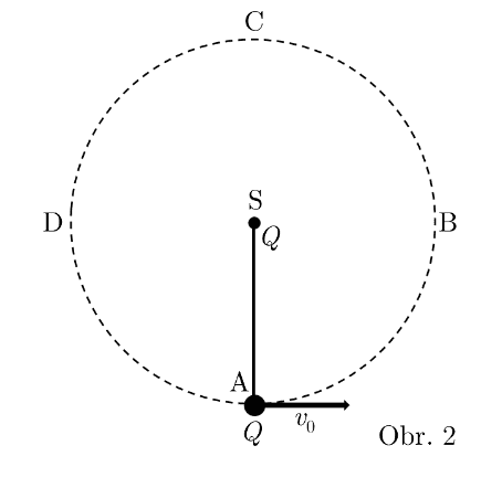

A small charged ball is attached to a string of a lenght ##l=10 \, \mathrm{cm}##. The ball have a charge of ##Q=10\,\mathrm {\mu C}##. The rope is attached to a point with the same charge ##Q##. What minimum speed do we need to give the ball for it to move in a full circle?
Solve for ##m=150\,\mathrm g## and ##m=50\,\mathrm g##.

I have propably described the problem poorly. The ball is moving in a vertical plane. Here is the picture that will describe it better:
Diagram of a dashed circular path with points C at top, B at right, D at left, and A at bottom, with a fixed charge Q at the centre marked S and a charge Q at point A moving with velocity v0 tangentially to the right, labelled Obr. 2.
Sorry for the confusion.

The point S has no mass and is fixed, the only thing that has a mass is that big black point - that is the ball. We know its mass. In the fist case, it is 150 g, in the second case, it is 50 g. So we should solve the problem for two different masses.
The points A and C correspond to my points 1 and 2. The speed ##v_0## corresponds to my ##v_1##.
The other points are relevant in the second problem, where I am to calculate tension forces acting in them. But that would be trivial after solving this problem.

So, for 150 g:
##m\frac {{v_2}^2 }{l}=mg-\frac{1}{4\pi \epsilon}\frac{Q^2}{l^2}##,
so ##{v_2}^2=gl-\frac{1}{4\pi \epsilon}\frac{Q^2}{m l}##.
##\frac 12 m{v_2}^2+2mlg=\frac 12 m{v_1}^2##,
so
##v_1=\sqrt{5gl-\frac{1}{4\pi \epsilon}\frac{Q^2}{m l}}=2.1\,\mathrm {m\cdot s^{-1}}##.
For 50 g:
##0=T_2+mg-\frac{1}{4\pi \epsilon}\frac{Q^2}{l^2}##,
but ##T_2## is not important. So
##2mlg=\frac 12 m{v_1}^2##
##v_1=2\sqrt{lg}=2.0\,\mathrm {m\cdot s^{-1}}##.
Is it correct?
Lotto said:
Is it correct?
I didn't run the numbers, but the equations agree with mine. Good job.
