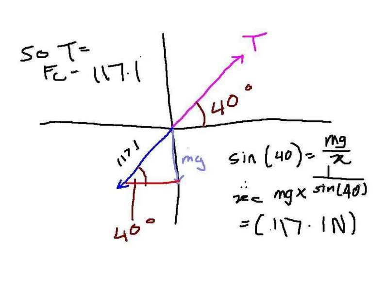

So if the centripetal force is the total force then F(net) = Fc?
And therefore Fc = Ft - Fgcos(θ) in the radial direction?
So basically I need to find the vector component of the weight force which acts in the opposite direction to the tension force but is still in the radial line? Is this what you mean?
So if the angled component of the weight force is 117.1 N in the negative direction and the centripetal force is 3917 N in the positive direction then the tension force is 3917 + 117.1 = 4034 N?
Or still not right? ):
You are getting close, but the projection of the weight force onto the radial is not 117.1 N. (hint: you correctly calculated the weight as Fg = mg earlier, you only need to project that magnitude onto the radial which are at an angle θ to the vertical).
But if the mg force is projected onto the radial isn't it at an angle 50 degrees from the vertical? So then solving for the hypotenuse I would still get 117.1 ):
I'm really confused about what to do, I've drawn many free body diagrams but I can't seem to get any other value from the triangle except 117.1 or 98.2 no matter what I try!
I drew a picture to show you what I mean ):
You are not projecting the mg vector correctly (hint: it is not the radial that is to be projected onto the vertical, but vice versa).
So...
77.24 x cos(50) = 49.65?
maviss said:
So... 77.24 x cos(50) = 49.65?
Correct.
And so T = 3917 + 49.65 = 3967 N?
