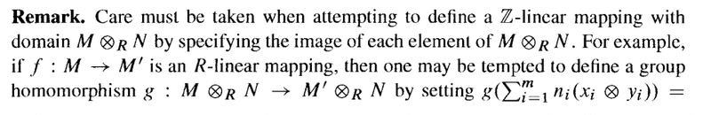

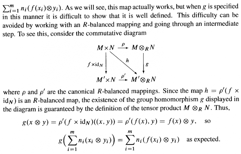

In the above text by Bland we read the following:
"... ... but when ##g## is specified in this manner it is difficult to show that it is well defined ... ... "
What does Bland mean by showing ##g## is well defined and why would this be difficult ... ...Question 2
"... ... Since the map ##h = \rho' ( f \times id_N )## is an R-balanced map ... ... "Why is ##]h = \rho' ( f \times id_N )## an R-balanced map ... can someone please demonstrate that this is the case?

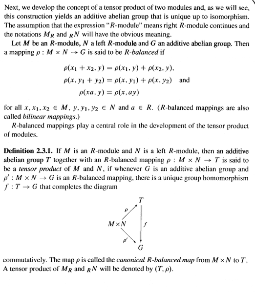

=============================================================================The following text including some relevant definitions may be useful to readers not familiar with Bland's textbook... note in particular the R-module in Bland's text means right R-module ...

In the example given, the purported definition of [itex]g[/itex] is that [itex]g(x\otimes y)=f(x)\otimes y[/itex]. If we think about what this means, it is saying that
$$g\Big(\chi_{(x,y)}+K\Big)=\chi_{(f(x),y)}+K'$$
where [itex]K[/itex] and [itex]K'[/itex] are the submodules of [itex]Z[/itex] and [itex]Z'[/itex] respectively that have the required 'zero' properties inherited from the modules [itex]M,M',N[/itex]; and [itex]Z[/itex] and [itex]Z'[/itex] are the free R-modules generated by [itex]{\{\chi_{(u,v)}\ :\ u\in M\wedge v\in N\}}[/itex] and [itex]{\{\chi_{(u,v)}\ :\ u\in M'\wedge v\in N\}}[/itex] respectively.
For this to be well-defined, we require that, for any [itex]a,c\in M[/itex] and [itex]b,d\in N[/itex] such that [itex](a,b)[/itex] and [itex](c,d)[/itex] are in the same coset of [itex]K[/itex], it will be the case that [itex](f(a),b))[/itex] and [itex](f(c),d)[/itex] are in the same coset of [itex]K'[/itex]. Otherwise, [itex]g[/itex] will not be a function because [itex]g\Big(\chi_{(a,b)}+K\Big)\neq g\Big(\chi_{(c,d)}+K\Big)[/itex] even though [itex]\chi_{(a,b)}+K=\chi_{(c,d)}+K[/itex]. Hence we have two different output values for a single input.
The argument involving the diagram appears to be a proof that [itex]g[/itex], thus defined, is indeed well-defined.

Regarding you post ... yes, understand ... so what you are saying is ... ... that when Bland talks about ##g## being "well defined" he means that if we choose a different element ... say, ##\sum_{ i = 1}^m n'_i ( x'_i \otimes y'_i )## in the same coset as ##\sum_{ i = 1}^m n_i ( x_i \otimes y_i )## ... ... then ##g## still maps onto ##\sum_{ i = 1}^m n_i ( f(x_i) \otimes y_i ) ## ... ... is that correct ...?
andrewkirk said:
Yes, that's right.
