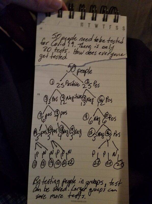

I am sure a culture can be made. It is unlikely just 1 out of 100 will be infected. None the less, the groups can be smaller or the test more sensitive or samples cultured. I hope this scratchpad picture helps with how the large group testing would be performed. https://www.physicsforums.com/threa...9-related-problems-and-no-one-to-tell.988420/

Re: concerns with dilution and sensitivity of tests due to pooling of samples for group testing.
