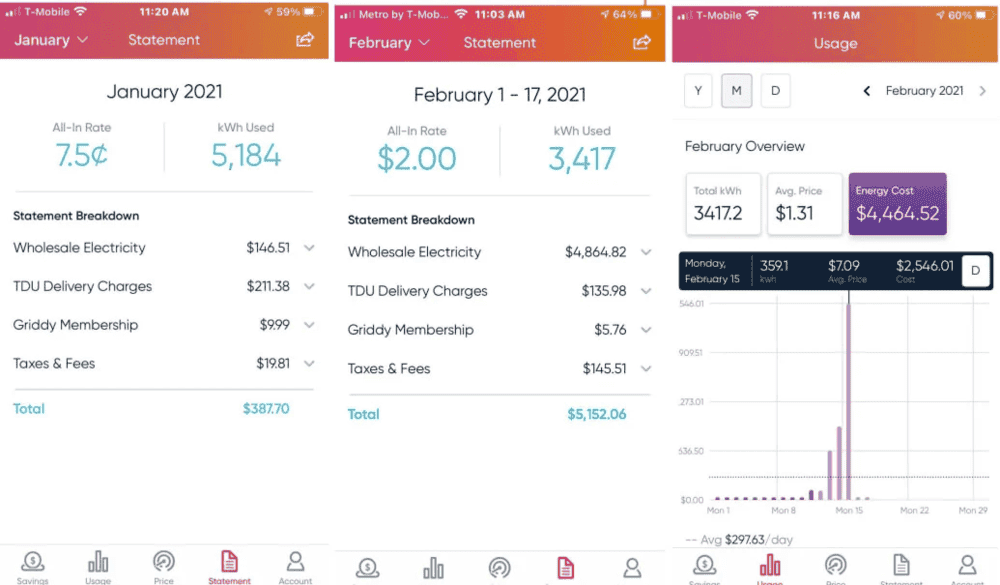

Yeah, but the point still stands. If you were using Griddy, you paid 8k dollars during the event. If you then get switched to a flat rate provider(by force), they are going to charge their customers more money to make up for their losses. That includes you, even though you already paid an 8k electric bill. So those customers are double paying for this

I think you're still missing my point. If you are using a flat rate provider, they are going to charge more for electricity from now until, like, 2022 to make up their losses. If you used Griddy, and paid your bill of 8k dollars, you might have been force moved to the flat rate provider who is now charging more for electricity going forward, to make up for their losses in February 2020.

If you used Griddy, and paid your bill of 8k dollars, you might have been force moved to the flat rate provider who is now charging more for electricity going forward, . . .
I understand one's point. But 'higher' should be qualified. How much higher?
I suspect many Griddy customers don't have $8000, or potentially ~$17,000 lying around to pay the February electric bill. For many that's probably ~100x what they normally pay in a month, and probably what they pay over 10 years; most probably pay a lesser multiplier. Some would probably have to pay off Griddy in installments over a year, or years. Anyway, Griddy is cutoff from purchasing electricity since they did not pay their bills. Many more electricity providers are faced with huge bills because of unprecedented rates (~$9000/MWh, or $9/kWh) + service fees, which should not have increased since systems were not delivering extraordinary amounts of electricity.

Finally, $17000 is a huge amount of power. Rates are capped at $9/kwh. $17000 = 1900 kwh,over 5 days is 15.7 kW. 24/7 for five days. (Can it be 24/7 if it's only 5 days long?) Put another way, the average Texan's bill is 1200 kwh per month. So Mr. $17000 is using almost 10x the power of a typical house. And presumably that's after he's cut back.
No idea who this is, but it's not the "poor single mom about to be evicted and thrown onto the street" we are supposed to get all weepy-eyed over. I can't imagine how one would use that much electrical power without a Bitcoin mine or a fleet of Teslas. Or both.
When you put real numbers in, it's not even clear that deciding to go with variable rates is irrational. The average Texas electric bill is $131. Let's say on average market electrical rates save 20% - much below this and it's not worth doing. So they save $26/month, but once in a blue moon get hit with a $1700 bill. Payback period is 66 months. I would characterize this as long, but not irrationally long.

Here is an example of a Griddy bill that's supposed to outrage us:
I am shocked (no pun intended) by the total energy use - 4.5x the average Texan's. I think I use a lot of electricity: 1100 kwh/mo. which includes the extra usage because of the lockdown and includes the fact I have an EV.
As far as the "social justice" aspect of "let's take down greedy Griddy", OK, now the person who used to be a secretary in Griddy's HR department is out of a job. How has this helped?
