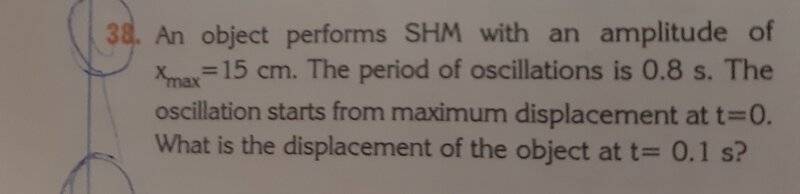

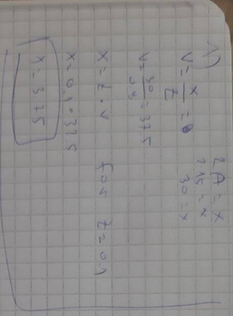

The 38 problem:The result on the book is 10.6cm i keep getting 3.75
X(t)=A×cos(w×t)
Please show your work so that we can figure out where you went astray.

You are assuming that SHM is motion under zero acceleration. It is not. The velocity in SHM is not related to position and time by ##v=\frac{x}{t}##. What are the correct expressions for position and velocity in SHM? Your textbook should have those.
And yes, please learn how to write equations in LaTeX. Meanwhile, please do no post pictures sideways.

How can you get a displacement of 37.5 if the max amplitude is specified as 15?
(This is intended to inspire a sanity check. If you mentally draw this motion in your head, that may help you figure out where you're going wrong.)

The only other equation i have is the one for the velocity in an instant of time v(t)=-vmax × sin(w × t).
W-omega
And i don't know what LaTeX is.

mm OK. Your notes say 3.75, though your problem statement says 37.5.
Not sure if you can still edit post #1.

So in your equation for x $$x(t)=A\cos\frac {2\pi t} T $$ Now what is A?
A is 15cm. Right?
so t/T is 1/8 for t=0.1s
