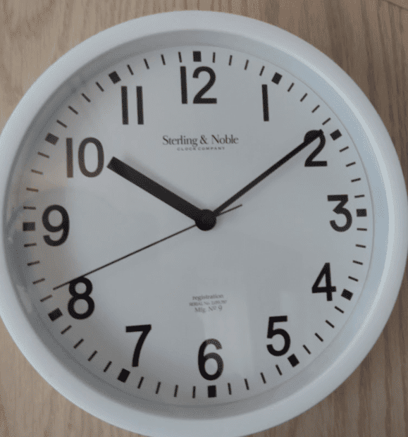

I'm curious about this failure mode.
I had a cheap ($3.82) wall clock from 2017. On Tuesday, it stopped working, getting stuck at the 41 seconds position. The second hand twitches every 1 second, but it does not advance. Since it was so cheap, I threw it away and bought a new one (also $3.82). The new one claims to be a different brand, but it failed in less than 1 hour use.
The new clock with a new battery, also fails the same way and also at the 41 second position. Actually, it stuck once at 49 seconds, but a dozen or more times at the 41 second mark. If I lay it down horizontally on a table, it keeps good time and doesn't get stuck.
I could spend $382.00 for a clock, but the money could go to cosmetics. Worse, it might have the identical quartz movement with a single AA battery. That movement seems ubiquitous in recent years. I've seen it in many brands of clocks.
Do those movements use stepper motors? Aside from the fact that 31-59 seconds is lifts the second hand and thus uses more torque, is there any good reason for random failures to result in such exact symptoms?
If the clock movement has injection molded plastic gears, there may be a remnant of the parting-line/sprue/gate- marks/ejector-pin-marks in the same place on both the old and new gears. That would make it a common mode failure.
Any more speculations?

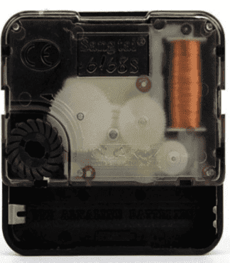

The clocks are driven by a small 1 Hz, 4 step motor with a PM rotor.
You can turn over the field winding so they run backwards.
Surprisingly, yes. I did not even know about this kind of stepper.

By the way, I found these movements for sale on alibaba.com for at little at $0.60 each.
The picture appears to show a solenoid plus a ratchet rather than a stepper motor.
But it really that type of stepper. Weird design, never would have thought that it's even possible.
I think the failure is due some poor manufacturing of the gears (loose gears can lock under force).

OK experiment complete.
  1. I replaced the old battery used during the initial failures.
  2. I verified that the clock still sticks at 41s. Confirmed.
  3. I hung the clock upside down.
  4. After 4 hours, it kept perfect time. @Rive's experiment confirmed.
  5. I re-hung the clock right side up. Sure enough, it promptly stuck again.
So I guess the lesson is: Weak batteries may contribute, but the sticking is likely caused by manufacturing imperfections in the plastic gears. The same imperfections may be present in different brands of clocks that use the same movement manufacturer.

As I think about it, the solenoid design in #16 is not symmetrical. The plunger works with gravity one way and against gravity the other way.
You may be able to rotate the gearbox by pi relative to the clock housing. The hands pull off easily. Might be a center nut or clips in back. So you will have the worlds most expensive 5 dollar clock. My refrigerator is now worth many thousands of dollars I reckon.
There are probably many ways of doing it.
In one, a single coil is wound on a core similar to the one shown. At the gap in the core, there is a hole that surrounds the PM rotor. You can see a white round gear at the bottom that hides the gap and rotor. The end of the rotor shaft can be seen in the transparent housing.
The crystal oscillator and divider produces a square wave output that drives alternate positive and negative pulses of current through the solenoid. Each pulse advances the PM rotor to the next position. The pulses to the solenoid were once produced by coupling the square wave through an AC electrolytic capacitor to the solenoid. I expect they are now generated by an internal digital pulse generator.
It appears the solenoid core is now asymmetrical, so the clock cannot be reversed by simply turning the core over. Reversing the solenoid terminals makes no difference, so modifying the rotor is the only way to reverse the clock.

The time relationship to peak torque, Tp, is;
45 seconds is 45 - 0 sec = 0° before Tp; Cos( 0 °) =100% of Tp. 0.0% to step to next.
44 seconds is 45 - 1 sec = 6° before Tp; Cos( 6 °) = 99.5% of Tp. 0.5% to step to next.
43 seconds is 45 - 2 sec = 12° before Tp; Cos(12°) = 97.8% of Tp. 1.7% to step to next.
42 seconds is 45 - 3 sec = 18° before Tp; Cos(18°) = 95.1% of Tp. 2.7% to step to next.
41 seconds is 45 - 4 sec = 24° before Tp; Cos(24°) = 91.4% of Tp. 3.7% to step to next.
40 seconds is 45 - 5 sec = 30° before Tp; Cos(30°) = 86.6% of Tp. 4.8% to step to next.
39 seconds is 45 - 6 sec = 36° before Tp; Cos(36°) = 80.9% of Tp. 5.7% to step to next.
If it can get to 43 seconds it will take 2.2% noise to get to 44 sec, then 0.5% noise to pass 45 sec.
So it looks like the time it stops is at about 8.6% short of peak torque when it will need 3.7% noise to advance.
Since the problem is position sensitive (rotating the clock body by pi), it sounds like a bad bearing surface is contributing to the problem.
