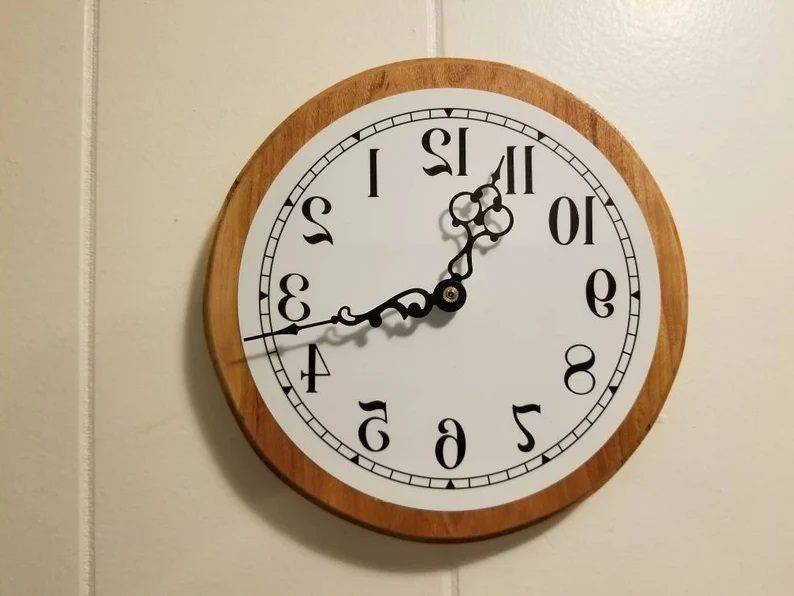

Baluncore said:Then how could you know that the clock had stopped ?
Instead of removing the second hand maybe just cutting it down to a very short nub will fix the problem and yet still allow you to see if it's moving or not.
- 11,327
- 8,758
Didn't the experiment of hanging it upside down prove that it wasn't just a question of torque?JT Smith said:Instead of removing the second hand maybe just cutting it down to a very short nub will fix the problem and yet still allow you to see if it's moving or not.

It could be wear to plastic on the uphill run, or redistribution of the lubricant.Dullard said:The 'upside-down' result is unexpected. I'm wondering if that is an artifact of the (previous) excessive wear on the gear teeth at the 'stall' position.
Rotating the second hand, relative to the gear that directly drives it, was not tested.
- 11,327
- 8,758
Did you read post #1? I started with an old clock stuck at 41s. I bought a new clock. It stuck at 41 s the first day.Dullard said:I'm wondering if that is an artifact of the (previous) excessive wear on the gear teeth at the 'stall' position.

Let me see if I can do better. I no longer have the old clock, just the new one. I am not sure if I can locate the old weak battery. But I'll do some tests and post the raw data.Baluncore said:That is one test, an enecdote.
But I resist the idea worn parts. The thread was triggered because the new clock started getting stuck in the very first hour of use, and the symptoms seemed the same as the old clock with ~35k hours of use.

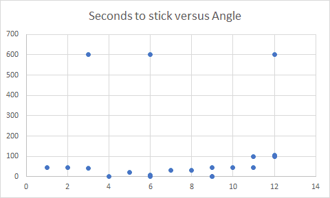

OK, I promised to run more tests. It took me a while to locate that weak battery. But I found it and did 20 tests. The raw data is below in the chronological order I measured them. So here's the experiment.Baluncore said:That is one test, an enecdote. I feel uneasy about it.
How long did the inverted test run?
Did you give it a fair chance to settle down and fail at maybe 11 or 41 sec?
- Put in the weak battery.
- Hang the clock with a certain angle. I express that angle in terms of the hour pointing up. Angle 12 is the normal orientation for a clock, angle 3 is 90 degrees on its side, angle 6 is 180 degrees upside down ...
- Measure how long for the second hand to get stuck. Some tests I terminated at 30 minutes. In those cases it might have continued indefinitely without sticking.
| Trial | Angle | Time Until Stuck |
| 1 | 12 | 30 seconds |
| 2 | 3 | > 30 minutes |
| 3 | 6 | > 30 minutes |
| 4 | 9 | 1 second |
| 5 | 12 | 100 seconds |
| 6 | 9 | 1 second |
| 7 | 11 | 100 seconds |
| 8 | 10 | 40 seconds |
| 9 | 8 | 30 seconds |
| 10 | 7 | 30 seconds |
| 11 | 6 | 7 seconds |
| 12 | 6 | 1 second |
| 13 | 5 | 20 seconds |
| 14 | 4 | 2 seconds |
| 15 | 3 | 40 seconds |
| 16 | 2 | 45 seconds |
| 17 | 1 | 45 seconds |
| 18 | 12 | 1 second |
| 19 | 9 | 45 seconds |
| 20 | 11 | 45 seconds |
Here is a plot, sorted by angle. I capped the maximum time to 600 seconds. Some tests were repeated, so there is more than one dot at the same angle.
Unfortunately, the data doesn't really support my theory that a flaw in the gears made it angle sensitive. There does seem to be slight angle sensitivity. However, I think the battery got weaker as I conducted the tests, and that swamped out other factors.
By the way, no matter the orientation angle of the clock. When the second hand did stick, it always did so in the 3rd quarter (180-270 degrees). That gives credence to the theory of increased torque to lift the weight of the second hand.
Note that this brand new clock started sticking on its very first day of service, so worn out parts should not be a factor.

I did one better. I removed the sweep second hand. Now, the clock runs indefinitely with the weak battery.NTL2009 said:Another test (if you are game), based on these results:
