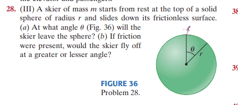

III) A skier of mass m starts from rest at the top of a solid
sphere of radius ##r## and slides down its frictionless surface.
(a) At what angle ##/theta## (Fig. 36) will the
skier leave the sphere? (b) If friction
were present, would the skier fly off
at a greater or lesser angle?

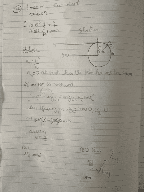

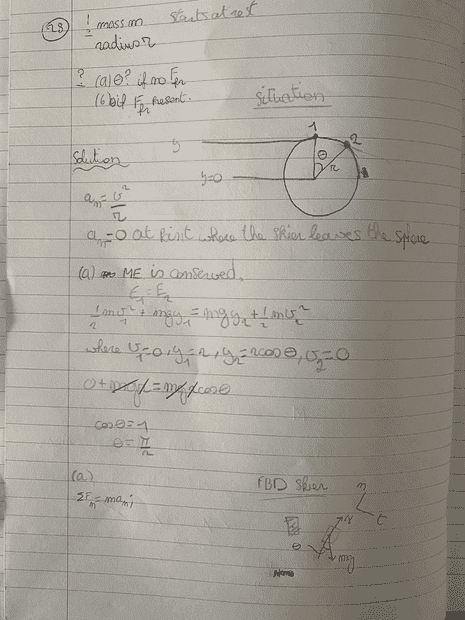

conserfation of mechanical energy concept(only translational KE considered)
Back here again.. but I am sorry guys, only the parameters are on my paper so wouldn't be of much help to show. I basically have no clue on how to start solving this problem at all.
I stopped yesterday and let it sit overnight but still have no clue on how to approach the problem basically. Because what in the world would indicate and thus tell me when it will leave that spehere.
It's a 3* problem as well.
So what I am asking is.. Could I get some tips on how to start this problems please?
Thanks in advance.
What do I know?
So grav force is the only one that's doing work aka energy stored. Normal force does no work for that's about it (a).
for (b) friction(NC force) is involved as well.
problem in picture format:
Textbook figure, Figure 36 for Problem 28: a green sphere of radius r with a skier at the top, angle theta measured from the vertical to the radius at the skier's position.
does it have to do something with where from ##a_n = v^2/r## ##r## becomes bigger or something and perhaps relate that to conservation of energy?
ONE SECOND I MIGHT BE ONTO SOMETHING... ##a_n## ACTUALLY BECOMES ZERO AT THE END ZO VELOCITY AT THE POINT WHERE THE SKIER WILL LEAVE THE SPHERE IS ZERO.
No. What you call ##a_n## is the centripetal acceleration required to keep the skier on the circular path. You need to think about what provides this centripetal acceleration and whether that is possible or not.

yep i came at pi/2 but now that I read it again it doesn't make sense that V is zero lol...
i will use NT's law to equate the force of gravity providing the centripetal acceleration to ##v^2/r## then?
Damn I will real close... pff

it's basically what I did here but taking centripetal acceleration into account. as the force that causes it.
Handwritten physics solution on lined paper: a circle diagram with a point at angle theta from the top and a mass m, with energy conservation equation E1 = E2 and cos theta = 1 step, followed by a free-body diagram of a sphere with N, mg and theta.
simphys said:
sorry this was a wrong
No, it wasn’t.
It is essentially impossible to tell what you have been trying to do here. Please type out your arguments and your math and don’t simply post pictures of scribbles assuming that we will understand what you mean.
