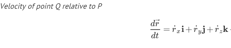

The fog is created created because they don't mention in which of the two frames of reference the expressions are worked out. For example :
Velocity of point Q relative to P $$ {d\vec r \over dt} =\dot r_x {\bf i} + \dot r_y {\bf j} + \dot r_z {\bf k} + r_x {d {\bf i} \over dt } + r_y {d {\bf j} \over dt } + r_z {d {\bf k} \over dt } $$
is in frame OXYZ ! (in frame Pxyx the ## {\bf i}, \ {\bf j}, \ {\bf k} \ ## are not moving!)
See also the last line in your picture: Q fixed to the body ##\Rightarrow \vec r ## is constant in frame Pxyz, so there the velocity is zero. ( ##\vec 0## ! ) The writers are so deep into the jargon that for them it is a problem to present the material in a didactically perfect manner. Victims are the newbies -- ironically it is those for whom the book is written.

Ah that makes sense. So to summarise would it be correct to say that the velocity of Q relative to P in the frame Pxyz is
(i.e. the exact same as in the frame OXYZ but without the di/dt, dj/dt and dk/dt terms)?
Thanks :)
Yes. And rz = 0.
