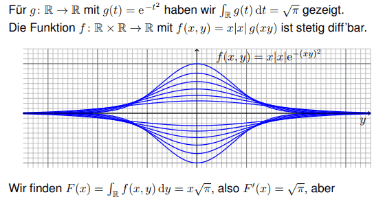

This is exactly what I do not see. The radius covers the entire space, so the integral matches the singularity at some point, regardless of how far away it is. The limit is always taken afterward! So I imagine an "alternating" function (to bypass ##L^1##), something in the realms of ##f(x,y)=x |x| \exp(-(xy)^2).## I know this isn't a counterexample, it is only my template to find one.
Family of blue curves plotted against y for several fixed x values, with bumps peaking above and below the y-axis and decaying to zero; labelled f(x,y) = x|x|e^(-(xy)^2).

Yes, but increase the power in the denominator and make ##g(y) \sim 1/|y|^\beta ## and we're back in business. I am not saying it is wrong. I simply do not see it. But I'm more an algebraic person than a topological.
There is still the magic trick with your compact balls to lock out the singularity, and the fact that you have ##\lim \int## and not ##\int \lim.##

##f \in L^1## is a strong statement. During my attempts to find a counterexample, I observed that ##\alpha \in (0,3)## and ##f\in L^1## are the crucial conditions here. So whatever "easier" proof there is, it will have to make use of them.
