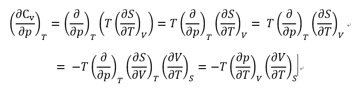

Show that derivative of Heat Capacity for constant V with respect of pressure for ideal gas is "zero"
(∂C_V/∂P)_T=0
C_V=T(∂S/∂T)_V, pV=nKT
I'm thinking about that for 1 hour. But, I could not do it.
Your result for ideal gas is written as ##-p(\frac{\partial V}{\partial T})_S > 0 ##.

Here's a hint: Start out by writing $$dU=\left(\frac{\partial U}{\partial T}\right)_VdT+\left(\frac{\partial U}{\partial V}\right)_TdV$$What are the partial derivatives in this equation equal to for the case of an ideal gas?
