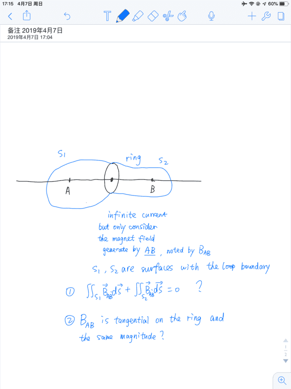

wuwei Messages 2 Reaction score 0 Thread starter Apr 7, 2019 #1 for a infinite length length of current, only consider a part of it, is the direction of magnet field of a ring on the mid vertical plane the same magnitude and along the tangential direction? and for a closed surface , if the flux is 0? Attachments QQ图片20190407171527.png 17 KB · Views: 524
Dale Mentor Insights Author Messages 37,455 Reaction score 16,572 Apr 7, 2019 #2 wuwei said: only consider a part of it You cannot do this. It is inconsistent with Maxwell’s equations. See https://en.m.wikipedia.org/wiki/Charge_conservation
