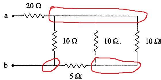

What is the equivalent resistance between points a and b:
[PLAIN]http://img706.imageshack.us/img706/8615/circuitq.jpg
The correct answer is Req=25 Ω. Looking into the circuit the 20 Ω is in series with the 10 Ω which is in parallel with the series combination of 5 Ω and 10 Ω resistos a, which is in parallel with the last 10 Ω resistor:
Req = 20 + [10 || (10+5) || 10]
[itex]R_{eq} = 20+ (\frac{1}{\frac{1}{10} + \frac{1}{15} + \frac{1}{10}}) = 23.75 \ \Omega[/itex]
My answer is slightly different from the model answer, so is something wrong with my calculation?
The 5Ω resistor is not in series with the middle 10Ω resistor; there's another resistor (the rightmost 10Ω resistor) sharing the node where they connect. For components to be in series they must be alone in a line and so pass the same, identical current.
I suggest that in this case you start at the "back end" of the circuit (the rightmost end) and work towards the front.
I think it should,
20 + 10 || ( [ 10 || 10] + 5 )
With a circuit like this, it's often extremely helpful to isolate your equipotential surfaces. This allows you to determine quickly whether various circuit elements are in series or in parallel.
Thank you guys, 20 + 10 || ( [ 10 || 10] + 5 ) worked. And the diagram was very helpful. :)
