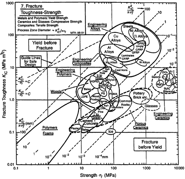

How hard can something be without being easily breakable?
The discussion centers on identifying the hardest materials that exhibit minimal brittleness, focusing on properties such as fracture toughness and resistance to damage. Tungsten, while hard, is deemed unsuitable due to its brittleness. Silicon carbide (SiC) and diamond are highlighted for their hardness, with SiC showing a fracture toughness of approximately 4 MPa/m0.5, making it significantly tougher than concrete. Steel emerges as a leading candidate for bulk applications, boasting a strength of ~1 GPa and a fracture toughness of 100 MPa m1/2, while advanced materials like woven graphene and carbon nanotubes are suggested for future exploration.

Mapes said:Engineering ceramics are still likely to fracture before they yield, however. For a material that can be made in bulk form today, I don't think you're going to beat steel (~1 GPa strength, 100 MPa m1/2 fracture toughness).
