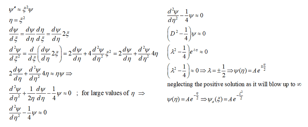

That is what I would call cheating... :-> I mean how did you know to look for such a product without knowing beforehand what the solution will look like.
My thoughts about this is to find some integration factor for the differential form: ##d(y'^2)-x^2d(y^2)=C## where ##C## is some constant.
You get this equation by multiplying ##y''= x^2 y## by ##y'##.
But I am clueless about how to find such an integration factor.

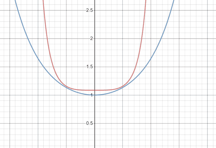

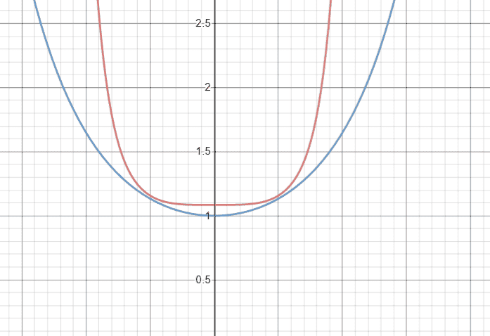

pasmith i tried to plug the series you provided in wolfram alpha to see how it goes , and i just picked the first few terms in the series which gave :
$$x^{4} +\frac{1}{12} (x^{4} + 1) + 1$$
on compairnig this to ##e^{\frac{x^{2}}{2}}## it was something like this :
for physicists i would say that this is a very good approximation 😀
but i have a little question : how would i get the other solution from the series which in this case will be the real physical solution corresponding to ##e^{\frac{-x^{2}}{2}}##

No, it's obviously wrong! You cannot solve the differential equation in this way!

i am not so obsessed 😅 i just was trying to find out why the ansatz is in this form , but i found another method to do that instead of the power series method , i just used a simple substitution then applied the asymptoticness :
it feels some how satisfying now i know a way to deduce this ansatz ! . :smile:🥳
