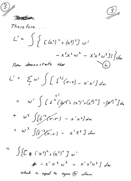

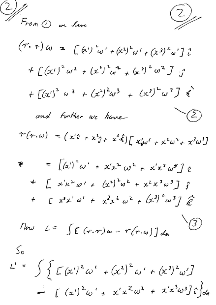

Thanks for the reply Orodruin ... Given that it should be straight forward i had another shot at demonstrating the Neuenschwander Equation 2.9 leads to (the compact and rather non-intuitive IMO) equation 2.11 ... I think my demonstration is OK ... but not completely sure ... details follow ...
Peter

Hope that is OK ...
Peter
You are way overcomplicating things by writing out all the terms explicitly. The ith component of any vector ##\vec v## is given by ##v_i = \vec e_i \cdot \vec v## and therefore
L_i = \vec e_i\cdot \vec L
= \int [r^2 \vec e_i\cdot\vec\omega - (\vec e_i\cdot \vec x)(\vec x\cdot \vec \omega)] dm
= \int [r^2 \omega_i - x_i (\vec x\cdot \vec \omega)] dm.
Now use that ##\omega_i = \delta_{ij}\omega_j## and ##\vec x \cdot \vec \omega = x_j \omega_j## (implicit sums over j due to the summation convention) and you obtain
L_i
= \int [r^2 \delta_{ij}- x_i x_j]\omega_j dm
where ##\omega_j## is constant and can be moved out of the integral.
