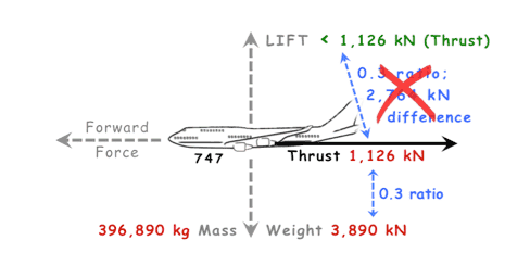

For example, Boeing 747-400 (B-747) specifications:
- A maximum mass of 396,890 kg provides a weight of 3,890 kN (i.e. 3,890 kN = 396,890 kg x 9.8 m/s2).
- Four Pratt & Whitney PW4062 engines each with a thrust of 281.6 kN provide a maximum total engine thrust of 1,126 kN (i.e. 1,126 kN = 4 x 281.6 kN).
- Aircraft thrust-to-weight ratio of 0.3 (i.e. 0.3 = 1,126 kN / 3,890 kN).
Image: B-747, Thrust / Weight = 0.3
But there is a problem. Applying these equations to the B-747 produces a result that is implausible. See image attached.
- It should be impossible for the B-747 to fly, as the lift required exceeds engine thrust by a wide margin of 2,764 kN. The B-747 would not even be able to take-off with engine thrust of only 30% of the lift required to fly. Yet the B-747 flies in practice.
- There is no plausible explanation how a B-747’s wings can produce lift 245%, or 2,764 kN, in excess of thrust. Lift cannot be created from nothing, and the engines are the only mechanism pushing the airplane forwards and up. Therefore, engine thrust must be greater than lift (i.e. Thrust > Lift). Not vice versa. Observations from airplanes in flight confirm this assertion. The backwash from engine thrust far exceeds the downwash from wings created due to lift, by a wide margin.
This analysis means that equation (c) ‘Thrust / Lift = 0.3’ is false. Hence a paradox arises, as both equations (a) and (b) appear to be true when stated individually, but when combined produce a result, equation (c), that is false (i.e. impossible).
Therefore, one of the equations (a) and (b) is also false, but which one?
(a) Lift = Weight
(b) Thrust / Weight = 0.3
Sources for data: www.boeing.com and https://modernairliners.com/boeing-747-jumbo/boeing-747-specs/

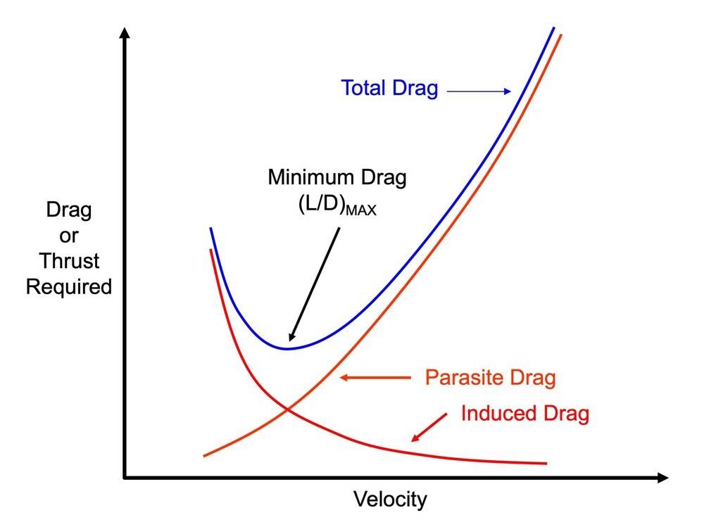

Most airplanes can fly in level flight at thrust to weight ratios of 0.07 to 0.10. They need more thrust to fly faster, to climb, and to accelerate to take off.
So how can lift be 10x the engine thrust? Where does the extra lift to fly come ?
Planes need more thrust to fly faster and slower. The maximum provided thrust to weight ratio is much higher than what is required for cruise flight.

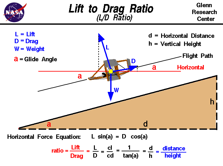

Again, what you seem to be missing is how much mass of air and at what velocity each, engine and wing, constantly moves.
Please, see:
https://www.grc.nasa.gov/www/k-12/airplane/ldrat.html

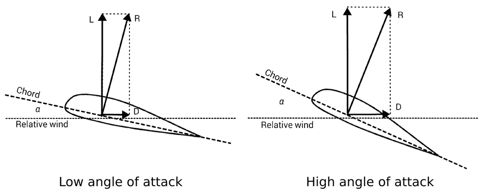

In the following real life diagrams, what force is always greater, L or D?
For level flight:
L = Weight
D = Thrust
