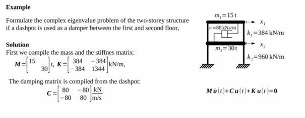

vibration of frame
m*a+k*x+c*v=q
when i solved simple example about 2 height stories when we have 2 degree of freedom I’m confusing about the meaning of result of eigenvectors and eigenvalues .
This is the example
Two-storey shear frame with a damper between floors; masses m1 = 15 t and m2 = 30 t, stiffnesses k1 = 384 kN/m and k2 = 960 kN/m, with the matrix equation M ü(t) + C u̇(t) + K u(t) = 0 and the mass, stiffness and damping matrices written out.

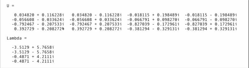

i'm getting 4 eigenvalues and 4 eigen vectors . as following
MATLAB-style output listing a 4 by 4 complex matrix U of eigenvectors, labelled U =, followed by a column of four complex eigenvalues labelled Lambda =.
I didn’t understand we have 2 MDOF and we are getting 4 values of eigenvalues and also eigenvector each vectors has 4 component , the eigenvector means the displacement of MDOF .
thank you
When you count all the state variables, position, velocity, acceleration, etc., that your model includes, how many degrees of freedom are there? Don't forget that in the general situation, you might start with nonzero initial conditions for positions, velocities, accelerations, etc.
