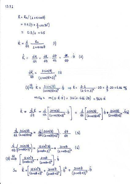

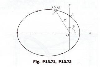

13.71 The path of the 3.6-kg particle P is an ellipse given by ##R = \frac {R_0} {(1+ecosθ)}##.
where R_0 = 0.5m and e=2/3. Assuming that the angular speed of line OP is constant
at 20 rad/s, calculate the polar components of the force that acts on the particle when it is at A.
Can you check this?
Everything looks good except equation (6), which has an error.

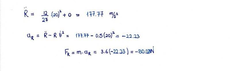

Can you check this?
Looks good.
