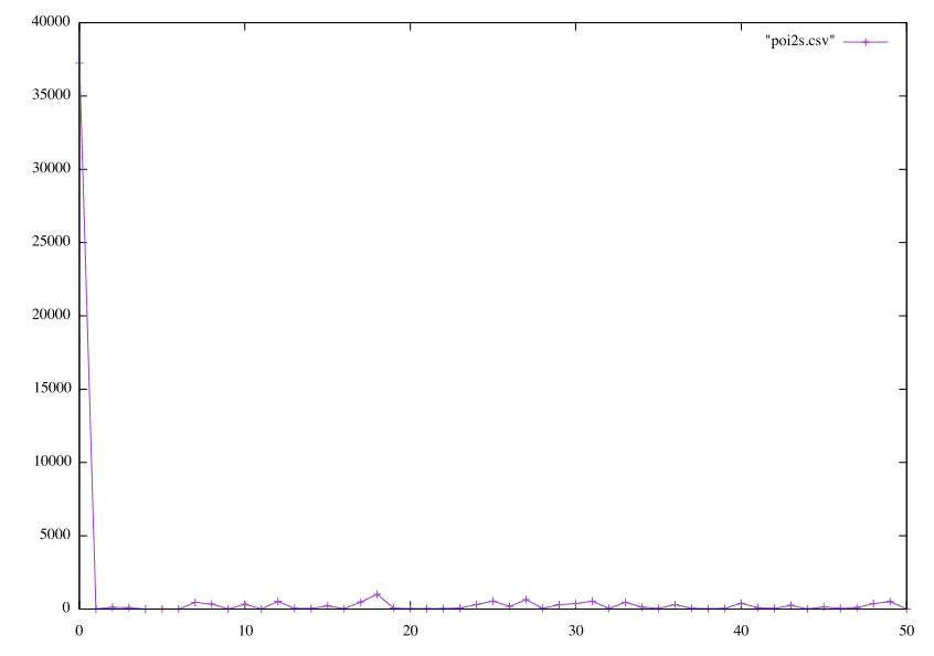

I have made the power spectrum of Poisson noise(expected value ##λ=2##), and it becomes like this
I think this is not good. I don't know why the power is so high when Random variable(x axis) is 0.
I tried another expected value version ,but the result didn't change.
so I would like to know the correct shape of the power spectrum of Poisson noise.

There is a huge DC offset in your data.
It needs to average close to zero to eliminate the zero frequency power.

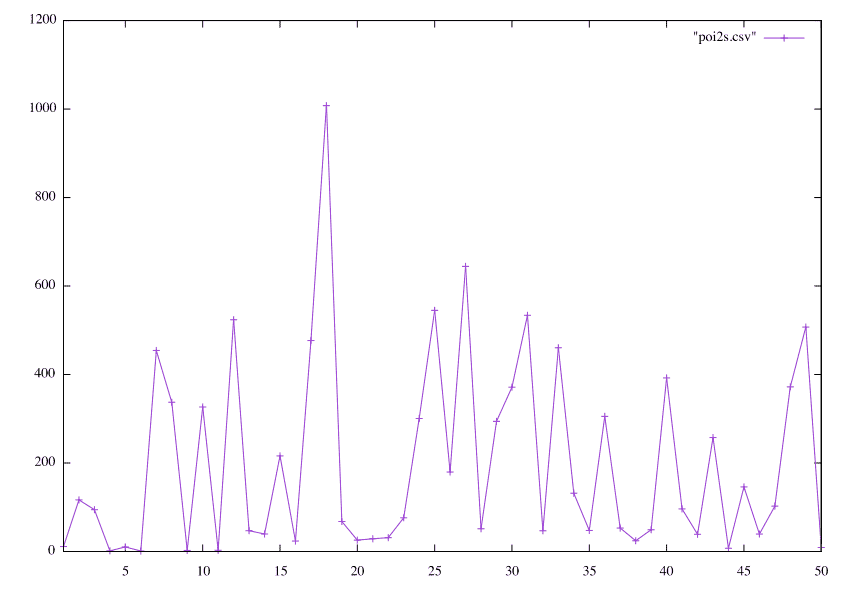

Can I just replace the power with zero?like this?
Yes.
I would expect a flat spectrum.

You use auto-scale, so the huge DC offset attenuated the data.

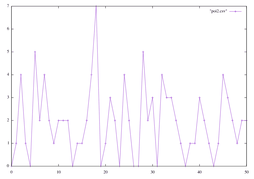

I do not know the structure of your input data. I expect it is randomly located positive pulses?
You should increase the number of points and the number of pulses to get better detail.
You might plot several on the same graph to see any repeated pattern.
You might accumulate the power spectrum to average out the structure of the spectrum.
