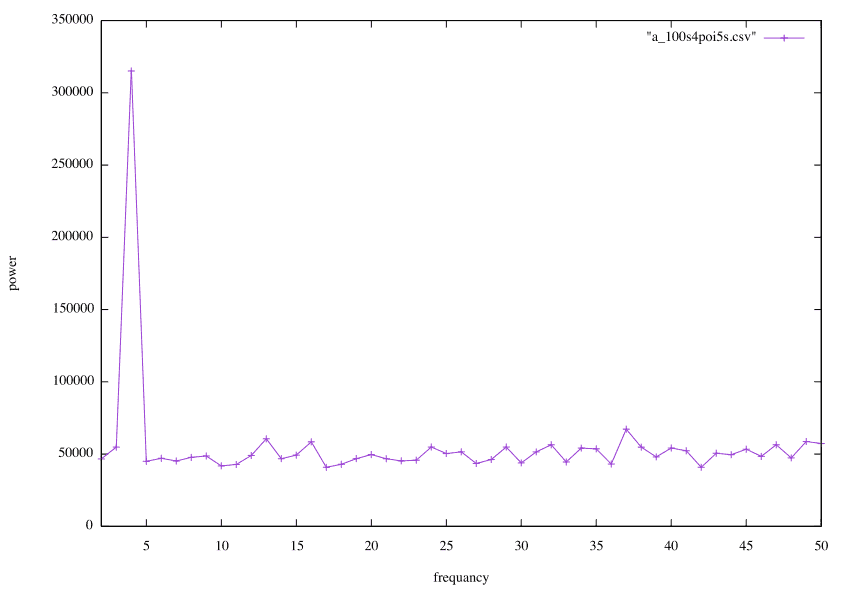

Hi all
I would like to know how to suppress the spectrum of Poisson noise.

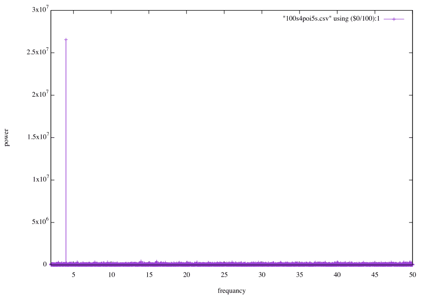

At first, I tried "binning". I made the data of Poisson noise which sums up 4Hz sin wave.(the data number##N=10000##,and the data time is 1s) and I average out the data every 100bins. After this, I derived the power spectrum of the data like this.
Second image is the power spectrum without binning.
As you can see, the noise power spectrum isn't suppressed.
All signal (Poisson + sin) are suppressed.
Is this means binning has no effect on Poisson noise??
I would like to know why this happens and how to suppress the poisson noise.
If you can help me, Please.(and sorry for my bad English)
Thank you

Averaging the data every hundred bins is like applying a kind of low pass filter. You are impacting the higher frequencies in the FT a lot more than the lower frequencies. It is also notable that different kinds of averaging techniques are possible. Playing with a moving average (each data point becomes the average of its N nearest neighbors) can provide some insight. Then trying moving weighted averages, where points further away are weighted less) can provide additional insight. But all these approaches are more like low pass filters.
Suppressing 4 Hz noise in your original signal would require a high pass filter or something that functioned like one. Off the top of my head, I can't recall simple averaging techniques that work like high pass filters. I'd recommend the extra work of a real high pass digital filter.

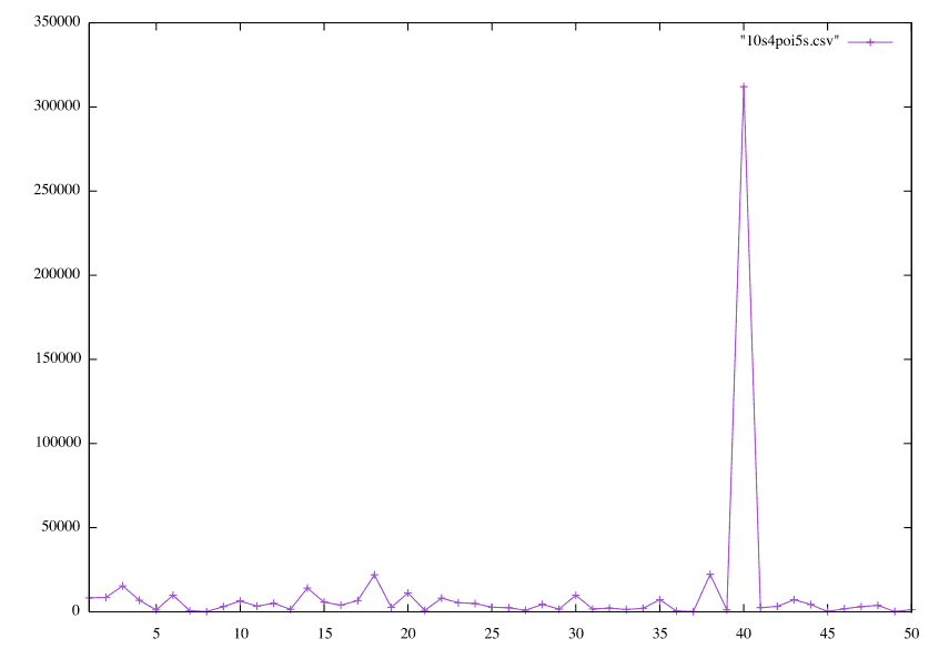

Ok @Baluncore
I tried N=10000, sampling time ##δt=0.01s##, so means all data time ##T=100s## version.
This is the spectrum.(I have changed the x-axis wave number to frequency)
In addition, I tried "rebinning". I average the data every 100 frequency bins.
It becomes like this.
The spectrum certainly is smoothed as the paper said, but I don't know this is meaning 😅
You change too many parameters.
4 Hz is a very low carrier frequency, or data rate.
What is the origin of your real signal?
How will it change or how is it modulated?
Are you looking for a regular pattern in x-rays from pulsars?
You must specify the centre frequency and modulation bandwidth of the signal you will detect.
Then we can fix sensible data acquisition parameters that will work later with real data.
Thank you @Baluncore !
No, I just made a sine wave signal.So this is a general case.
And I think I have changed only the data number##N=##100→10000.(##T=δt*N##)
Please let me organize my question.
As you can see the image, I think I can recognize the difference between sin and noise. Because I change the data number ##N##, I think.
And When I rebinning the data ##N=10000## , the noise spectrum is smoothed.
But Does it have meaning?? I already recognized the difference.
And I hope my English isn't so bad 😭
