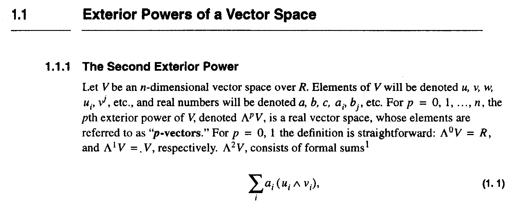

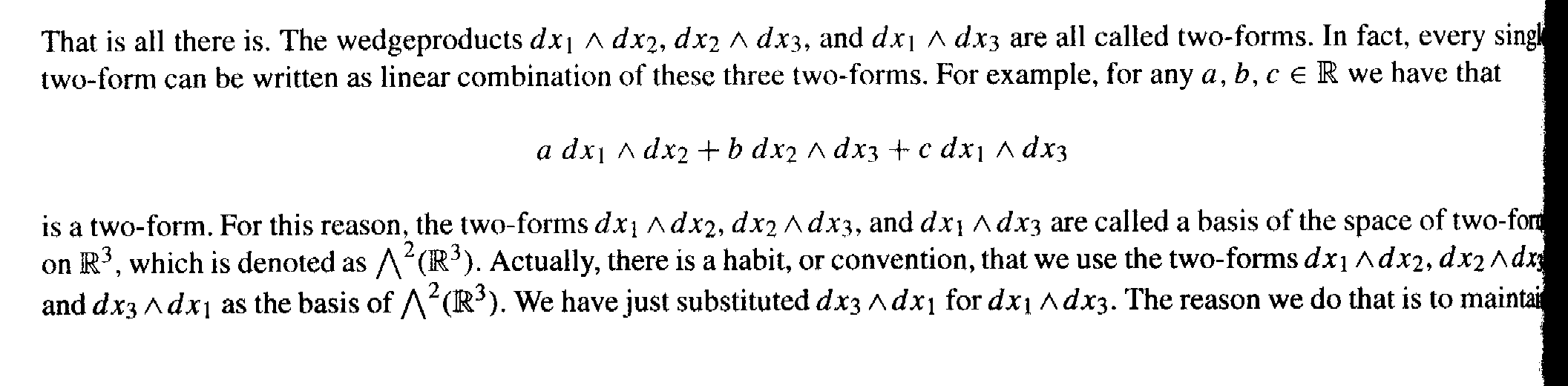

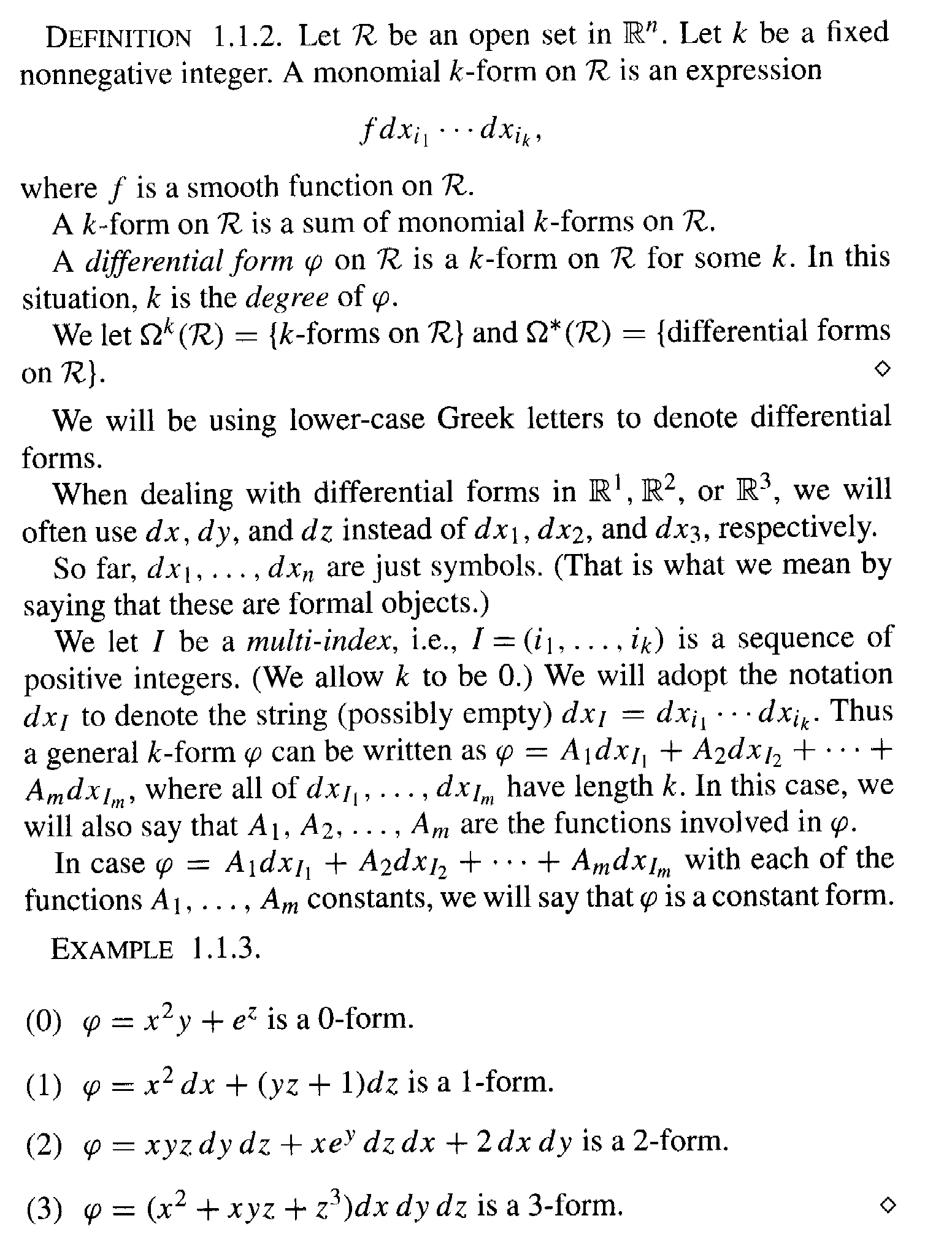

I have a question regarding the nature of 2-forms (indeed k-forms ... but I'll focus the question on two forms ... ) ... Defining 2-forms and the space $$ {\bigwedge}^2 ( \mathbb{R}^3 )$$ , Jon Fortney in his book: A Visual Introduction to Differential Forms and Calculus on Manifolds, writes the following:View attachment 8783R. W. R. Darling in his book defines $$ { \bigwedge}^2 V $$ similarly when he writes the following:View attachment 8784... BUT ...Steven Weintraub in his book: Differential Forms: Theory and Practice defines k-forms (and hence 2-forms ...) as follows:View attachment 8785(NOTE: Weintraub omits the wedge notation writing the wedge product $$dx \wedge dy$$ as just $$dx dy$$ ... ... )
My question is ... how do we reconcile the differences between Fortney and Darling's definition of a 2-form and the space of two forms ... with Weintraub's definition ...
Essentially ... Fortney defines a 2-form as
$$a dx_1 \wedge dx_2 + b dx_2 \wedge dx_3 + c dx_1 \wedge dx_3 $$
where $$a,b, c \in \mathbb{R} $$... while Weintraub defines a 2-form as $$f_1 dx_1 \wedge dx_2 + f_2 dx_2 \wedge dx_3 + f_3 dx_1 \wedge dx_3 $$
where $$f_1, f_2,$$ and $$f_3$$ are smooth functions ...
Can someone please help reconcile the differences between the definitions of Fortney and Weintraub ...?Help will be appreciated ...

Hi Peter,
Weintraub is defining a differential $k$-form, which is one where the smooth function $f$ is used to allow the coefficients to vary from point to point (as opposed to the fixed values of $a$, $b$, and $c$ used by Fortney). Also, you are correct that $f$ is a smooth, real-valued function.
