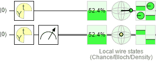

Here's a circuit diagram showing it happening. Notice how the probability of a wire being measured as On (+Z instead of -Z) closely tracks the vertical position on the Bloch sphere representation of the wire's state, and how the measured wire's state is pinned along the Z axis:
Circuit simulator screenshot of two qubit wires, each showing a Bloch sphere, a probability readout of 52.4%, and a density bar; the top wire has a measurement gauge and the bottom wire does not. Caption: Local wire states (Chance/Bloch/Density).
