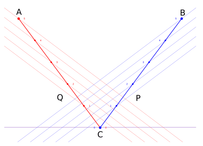

In the frame in which points A, B and C are constantly at rest, let's say Q moves with -0.75c from C to A, and P moves with +0.75c from C to B. If both clocks P and Q are initially indicating 0 when they depart from C, it is clear that they both will indicate the same time, let's say 5 seconds.
How is this compatible with mutual time dilation? Well, we have to consider relativity of simultaneity:
From Q's perspective, the thin red lines of simultaneity tell us, that 1 second Q time corresponds to ~0.3 seconds P time, and 2 seconds Q time corresponds to ~0.5 seconds P time, ... and finally 5 seconds Q time corresponds to ~1.4 seconds P time. So P is retarded with respect to Q.
From P's perspective, the thin blue lines of simultaneity tell us, that 1 second P time corresponds to ~0.3 seconds Q time, and 2 seconds P time corresponds to ~0.5 seconds Q time, ... and finally 5 seconds P time corresponds to ~1.4 seconds Q time. So Q is retarded with respect to P.

Just to emphasize what @Histspec's diagram is showing, the horizontal axis shows position in space according to a person using the frame where A, B and C are at rest and P and Q are moving with equal and opposite velocity. The vertical axis shows time according to the same frame. If you've come across displacement-time graphs in physics at school, that's pretty much all it is, except that time is shown vertically and displacement horizontally.
So if you draw a horizontal line across that you see space (or, at least, the contents of the line ACB) at one instant of time. If you draw the line higher up, you see the blue and red lines representing P and Q cross the line further apart, as they are further apart at a later time.
Where that is really interesting in relativistic physics is that it models everything as spacetime - so that graph suddenly gets promoted from "just a graph" to "a map of spacetime" (or at least, a map of time and one spatial dimension - the whole thing would be a 4d object). And, just like there are no grid lines on a map except the ones you draw, there are no grid lines on this except the ones Histspec drew. And two people don't have to draw the same gridlines. Relativity tells you how observers in motion with respect to each other would usually choose to draw them, and those are the fine red and blue lines. They aren't the same as each other, or the horizontal ones. So they have a different ideas of what "all of space at one instant of time" means. And that's why the time dilation being symmetric isn't a contradiction - A, B and C may say that P and Q arrived at their destinations simultaneously and their clocks stopped simultaneously, but P and Q do not say that. They both say that the other reached their destination later, so are not surprised that the other's slower-ticking clock stopped showing the same time as their own.
