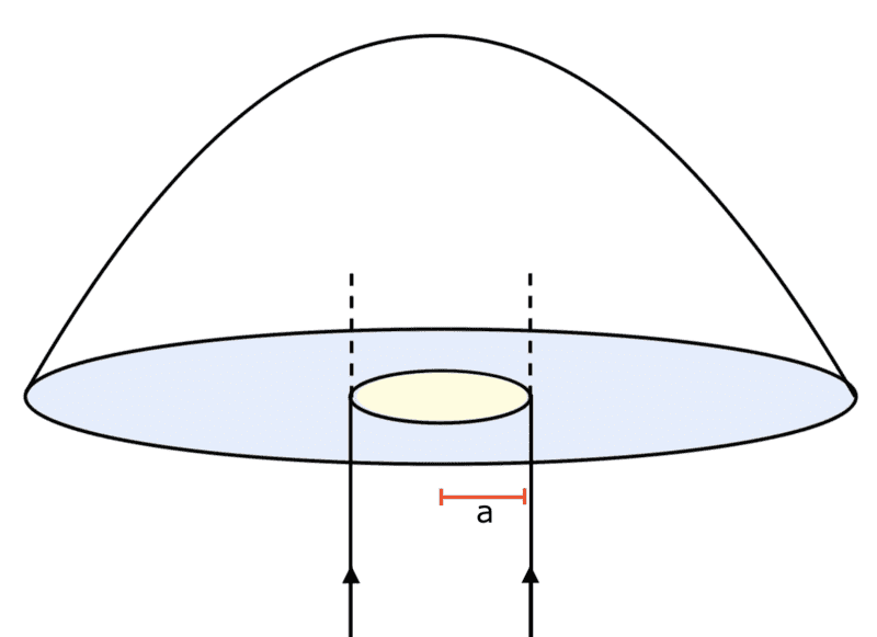

A vertical beam of light of power ##P## and radius ##a## is incident on the base of a glass hemisphere of radius ##R##, weight ##W## and refractive index ##n##. Given that ##a \ll R##, determine the power ##P## of the beam such that the hemisphere hovers in static equilibrium. Neglect all terms in ##(a/R)^3## or higher order.

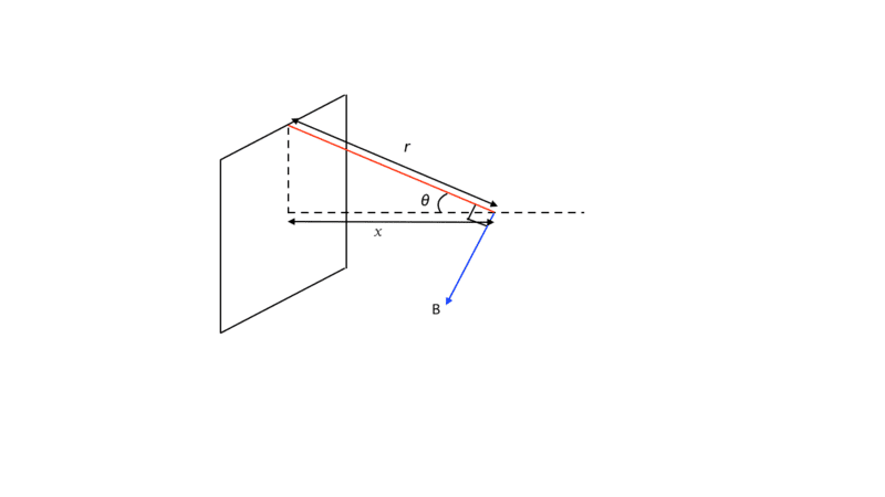

Calculate the magnitude of the magnetic field produced by a square loop of side length ##a## and carrying a current ##I## at a point a distance ##x## along the axis of the loop from the centre of the loop.

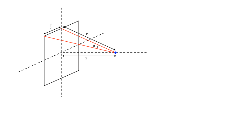

Problem 6
From symmetricity, the total magnetic field at ##x## due to the loop should 4 times the magnetic field at ##x## due to each side times the . {see figure}
magnetic field due to straight wire of finite length is,
$$B=\frac {\mu_oI[\sin\alpha+\sin\beta]} {4\pi r}$$
here, ##\sin\alpha=\sin\beta=\frac a {2\sqrt{(\frac a 2)^2+r^2}}##
and ##r=\sqrt{(\frac a 2)^2+x^2}##
on putting these values we should get,
Magnetic field due to loop, see edit
Edit: I forgot that we would also have to multiply the answer by ##\sin\theta## (see figure) the ##\cos## component cancels out,
So the final answer should be,
$$B= \frac {4\mu_oIa^2} {\pi (4x^2+a^2)\cdot\sqrt{(4x^2+2a^2)}}$$
Edit(II): I also used the wrong value of ##\sin\alpha## initially.
There's a mistake [now corrected] near the beginning of your work; note that ##\sin{\alpha}=\sin{\beta} = \frac{a}{2} \cdot \frac{1}{\sqrt{r^2 + \frac{a^2}{4}}} = \frac{a}{2\sqrt{x^2 + \frac{a^2}{2}}}## instead of ##a/2r##. It should be clear why if you draw a plan view of the triangle you constructed. Try fixing that and see what you get! And as you mentioned in the edit, with your method you do also need to take into account the factor of ##\sin{\theta} = a/2r## to get the projection onto the ##x##-axis.
Also, I managed to reproduce your formula for the magnitude of the field due to a finite wire but it'd be good to also show where that comes from, i.e. do the Biot-Savart integral!
etotheipi said:
There's a mistake near the beginning of your work; note that ##\sin{\alpha}=\sin{\beta} = \frac{a}{2} \cdot \frac{1}{\sqrt{r^2 + \frac{a^2}{4}}} = \frac{a}{2\sqrt{x^2 + \frac{a^2}{2}}}## instead of ##a/2r##. It should be clear why if you draw a plan view of the triangle you constructed. Try fixing that and see what you get! And as you mentioned in the edit, with your method you do also need to take into account the factor of ##\sin{\theta} = a/2r##.
There were lots of mistakes in my answer, hopefully its now corrected
Looks right with the edit! Nice work :smile:

For P:roblem #4 the Force limit for large n (very very slow glass) should not go to infinity..somehow there should be an ##n^2## in the denominator. You cannot assume ##\theta ## small if n gets large even if it is small compared to R.
the force does diverge, but the power does not diverge, if ##n \rightarrow \infty##
(we assume no light is reflected internally, so ##\theta## may still be assumed small in limit of large ##n##)
i.e. the ##(n-1)^2## is on the denominator
##P \sim 4cR^2 W / a^2(n-1)^2##
Why would the Force diverge? I think the physics of n large would just be the same as absorbing the whole beam because of total internal reflection if nothing else...How would you get infinite force? So your approximation is more a than limit on a/R.
I think a more careful treatment of the surface shape will get you there. Can't do it right now...
there is no mistake
internal reflections are neglected
it is a hemisphere!
To settle this, you obviously need to get a glass hemisphere and a laser and see if you can make it float at the predicted power. YouTube video or it didn't happen

OK I worked it through and you are exactly correct, although the expansion parameter is in fact (n-1) a/R so my limiting case is excluded.
