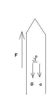

shabby_goblin
A spaceship accelerates with constant acceleration to 120 m / s within 10 seconds after launch from Earth.
Imagine that one of the astronauts who weighs 77 kg sits on a bathroom scale while the Launch takes place.
What does the scale show during the launch ?
120m/s : 10 s = 12 m/s2
My teory is:
F=m(g+a)
F=77 kg (9,81 m/s2+ 12 m/s)
F=1679,37N
1679,37N / 9,81 = 171 kg
So the scale show 171 kg
that is right. What is the problem?
Well i didnt state my problem O_o.
It is that we are 4 peeps arguing on what's right.
Some just want to take F = m*g which is F=77 kg * 12 m/s2 = 924N
But i mean that since this is on Earth gravity has to play a part in this.
So everything is right in what i stated above ?

How do you get this: F=m(g+a). Can you show me?
If you look on the drawing I've added then the forces in work here should be
ƩF = G + a
ƩF = m x g + a
ƩF = m x (g+ a)

Assuming the scale has been calibrated to show 77 kg when the astronaut sits on the pad it is perfectly valid to answer either that the scale reads around 171 kg or 1680 N, depending on the exact value of g used. Or in other words, the scale shows around (g+a)/g = 2.22 times the calibrated weight of items when accelerated like that.
